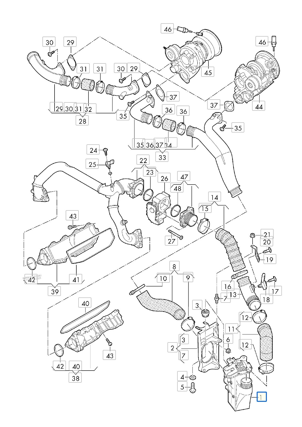

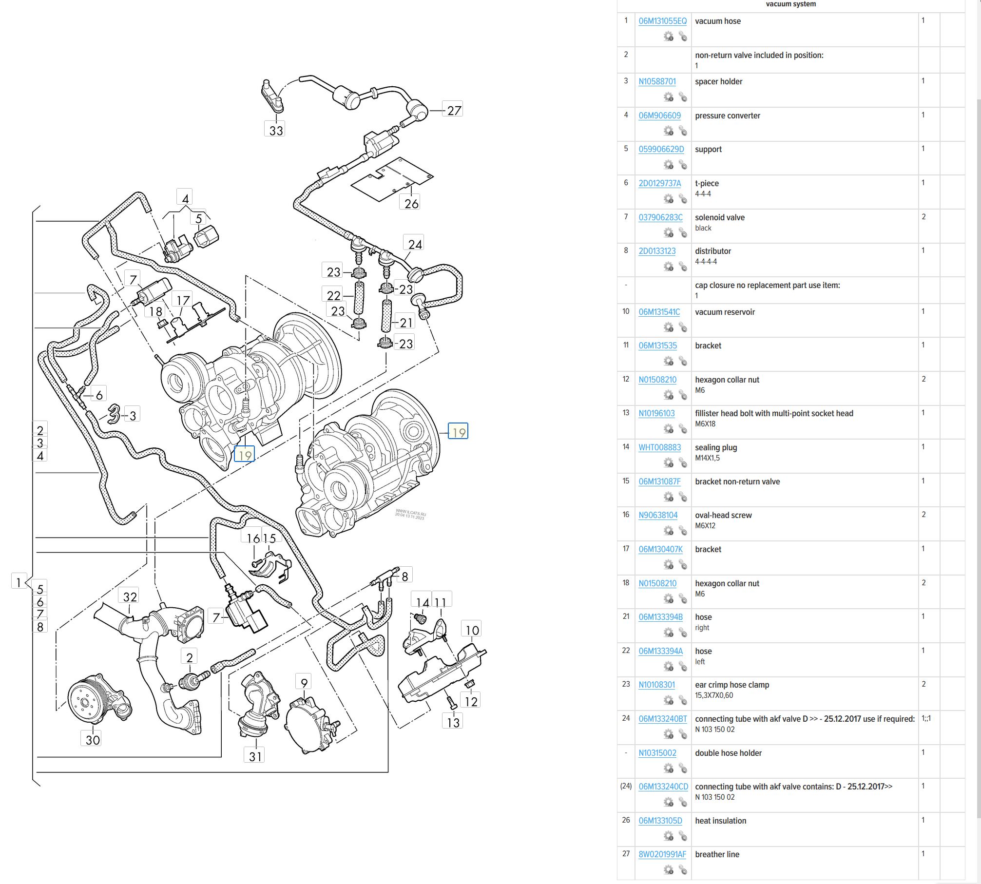

As you accelerate hard watch the boost pressure on your dash (mine is bottom right) I would expect yours may not be building pressure as it should.
I would think this would be as SuzaFan says a blown off or leaky induction pipe, or you may have a vacuum leak on the turbo side, or a failed / sticky turbo vacuum actuator.
I have added a couple of images of the pressure and vacuum side of the turbo's.
