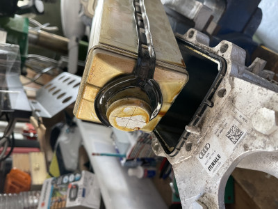

If you remove the six retaining screws in the top you can pull the inner radiator out.

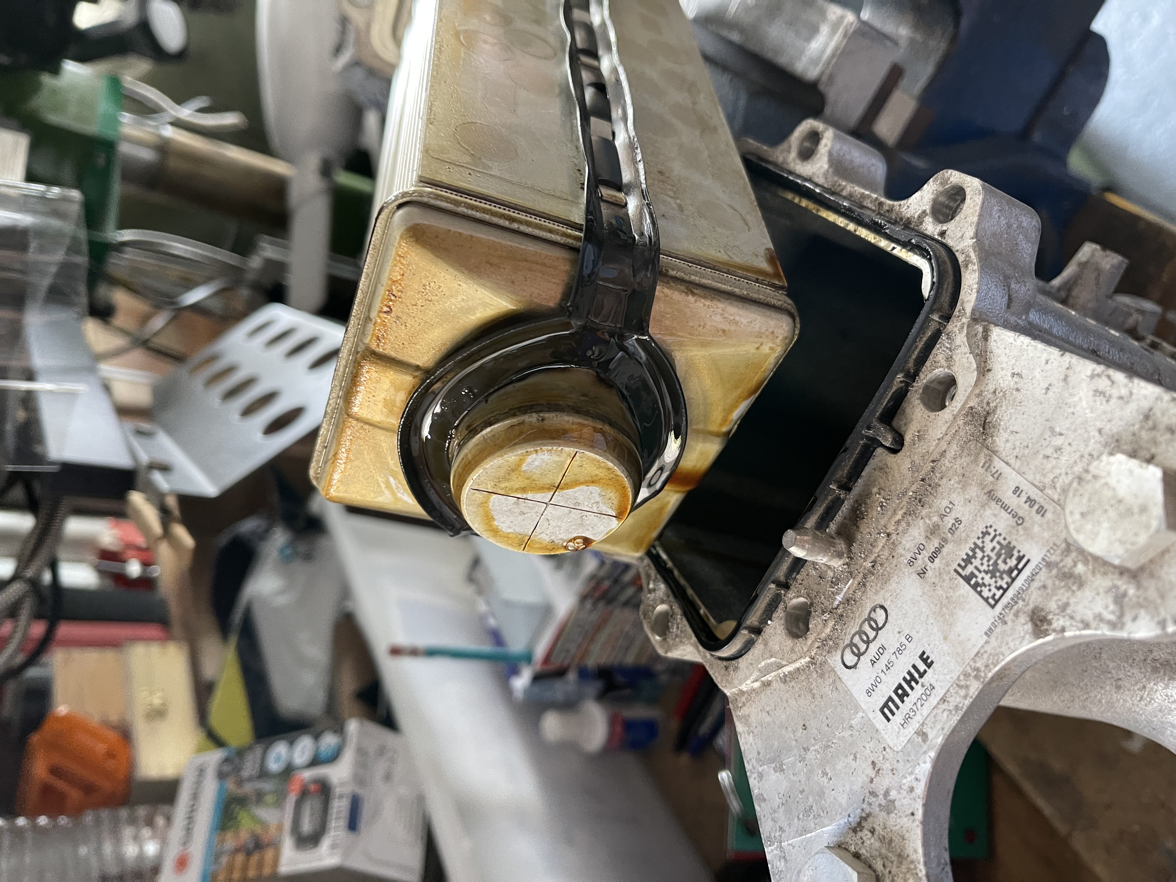

It was then I found out what the reflection I had seen was, oil!
There was a small puddle of oil in the bottom of the charge cooler, pictures below.
In all I used nearly two cans of clutch and brake cleaner getting rid of it in the main body and the radiator matrix.
I think about 10% to 15% of the radiator matrix was blocked with oil, which would reduce air flow to the engine.

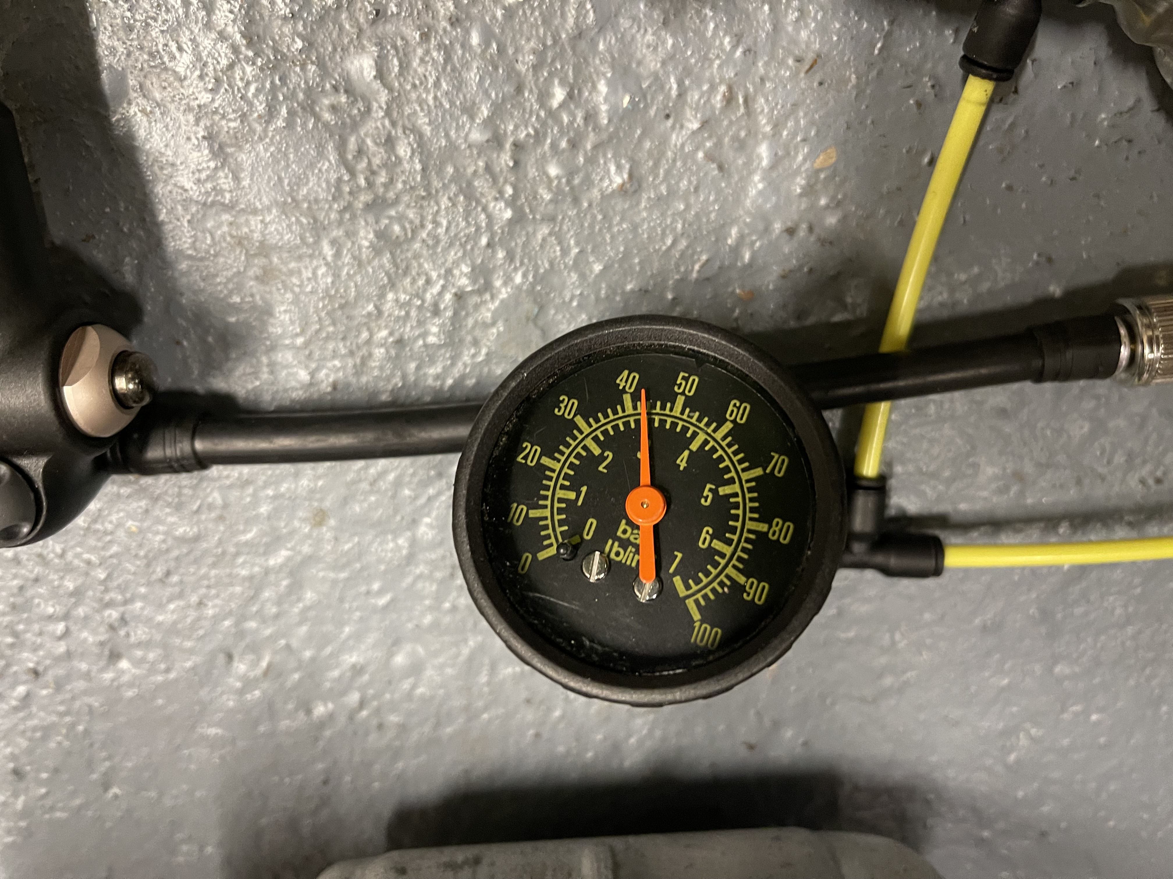

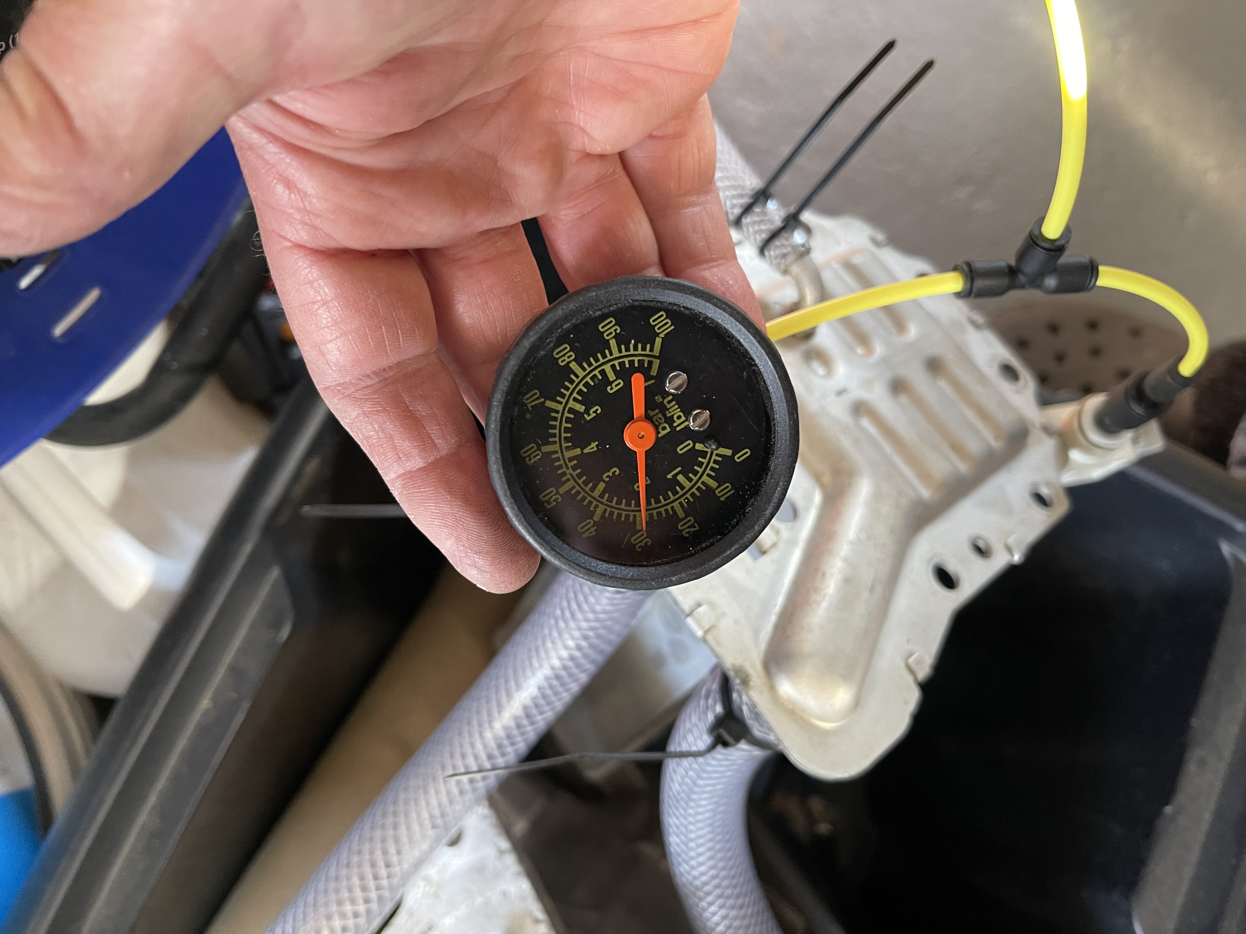

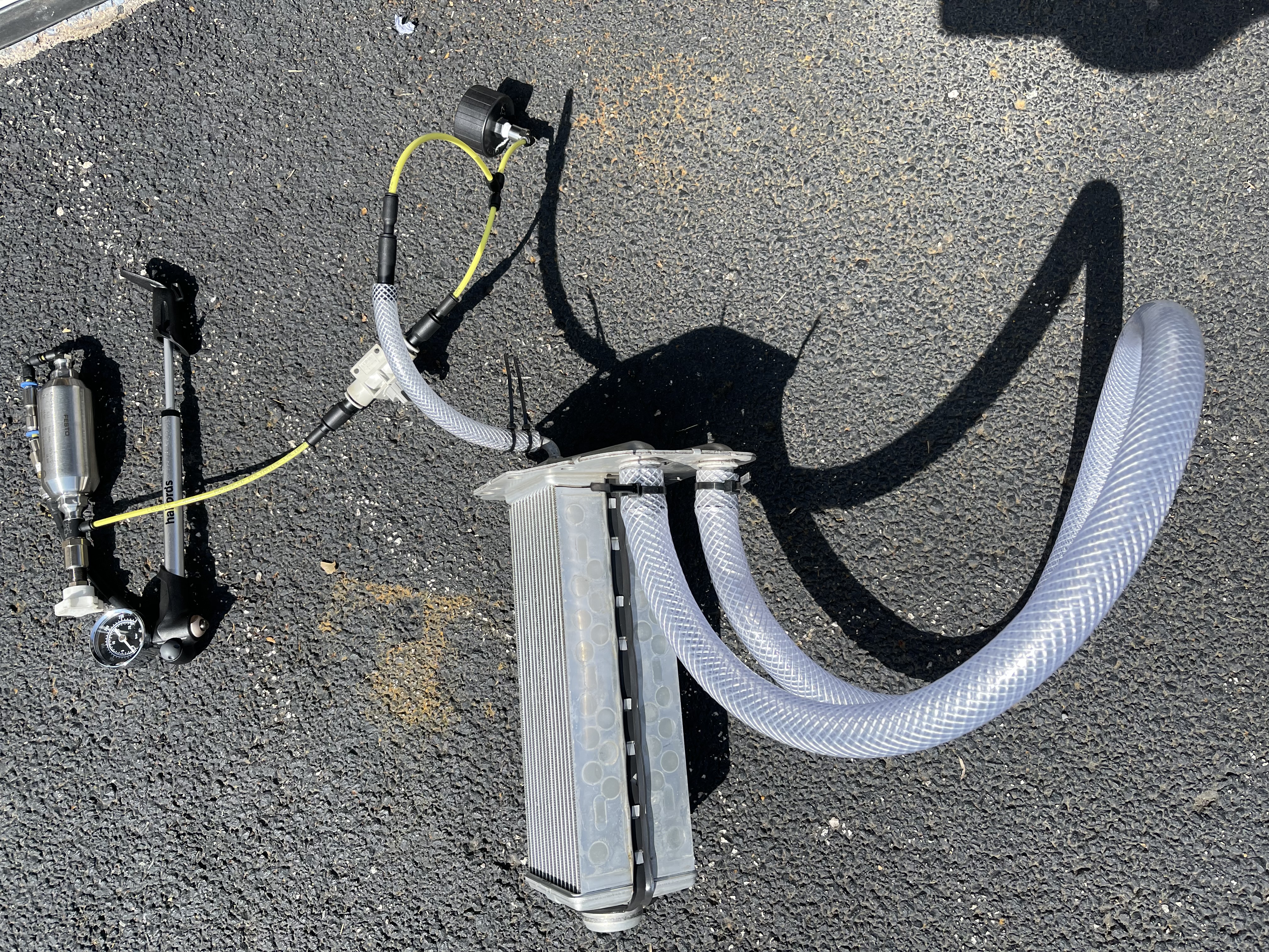

Once cleaned I made up a quick pressure tester for the (water side) radiator matrix and pumped it up to 2bar.
2bar is the max pressure the water system will take before the cooling system overflow tank filler cap is designed to pop off.
I left it over night and it held its pressure, winner.

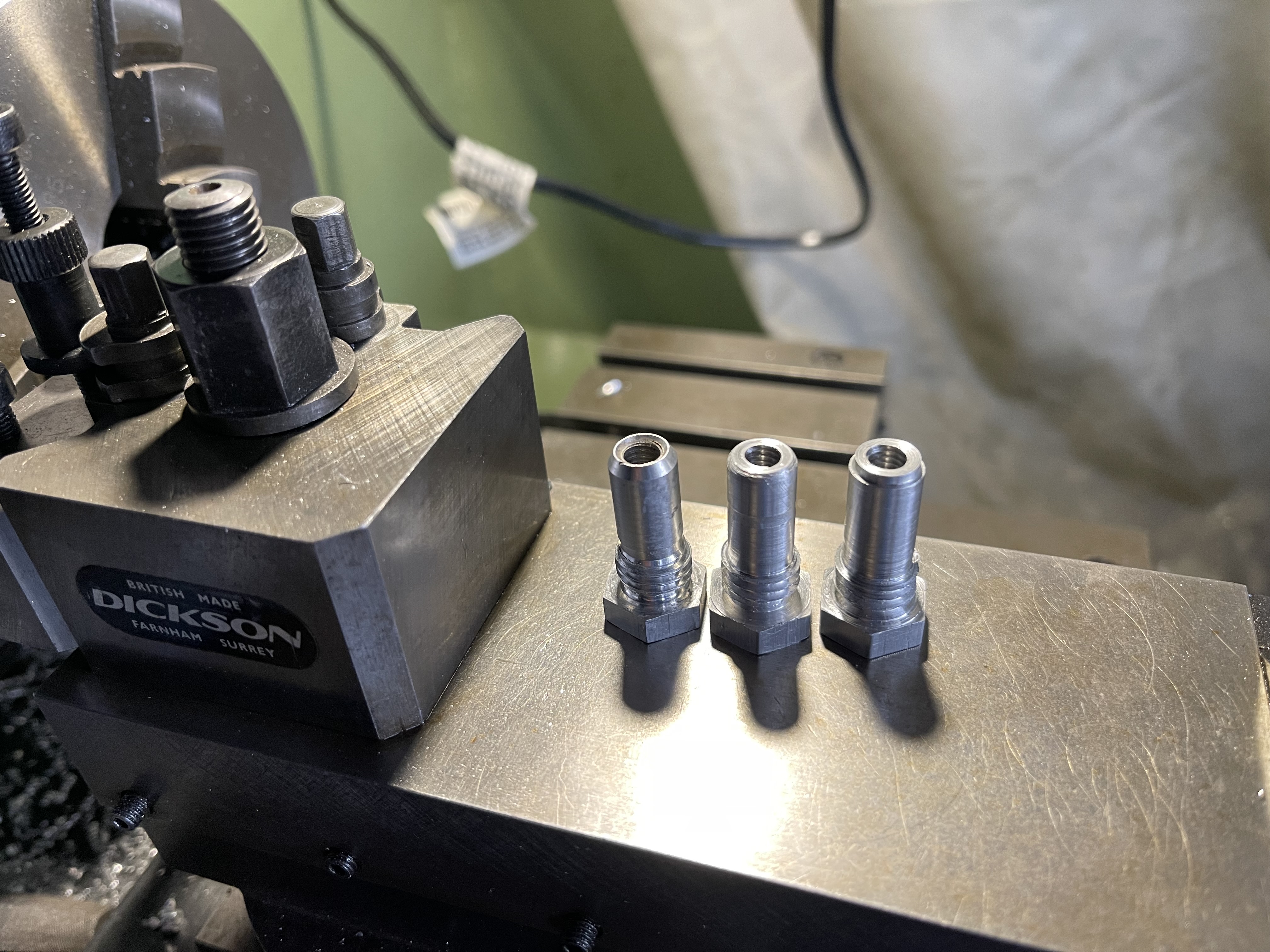

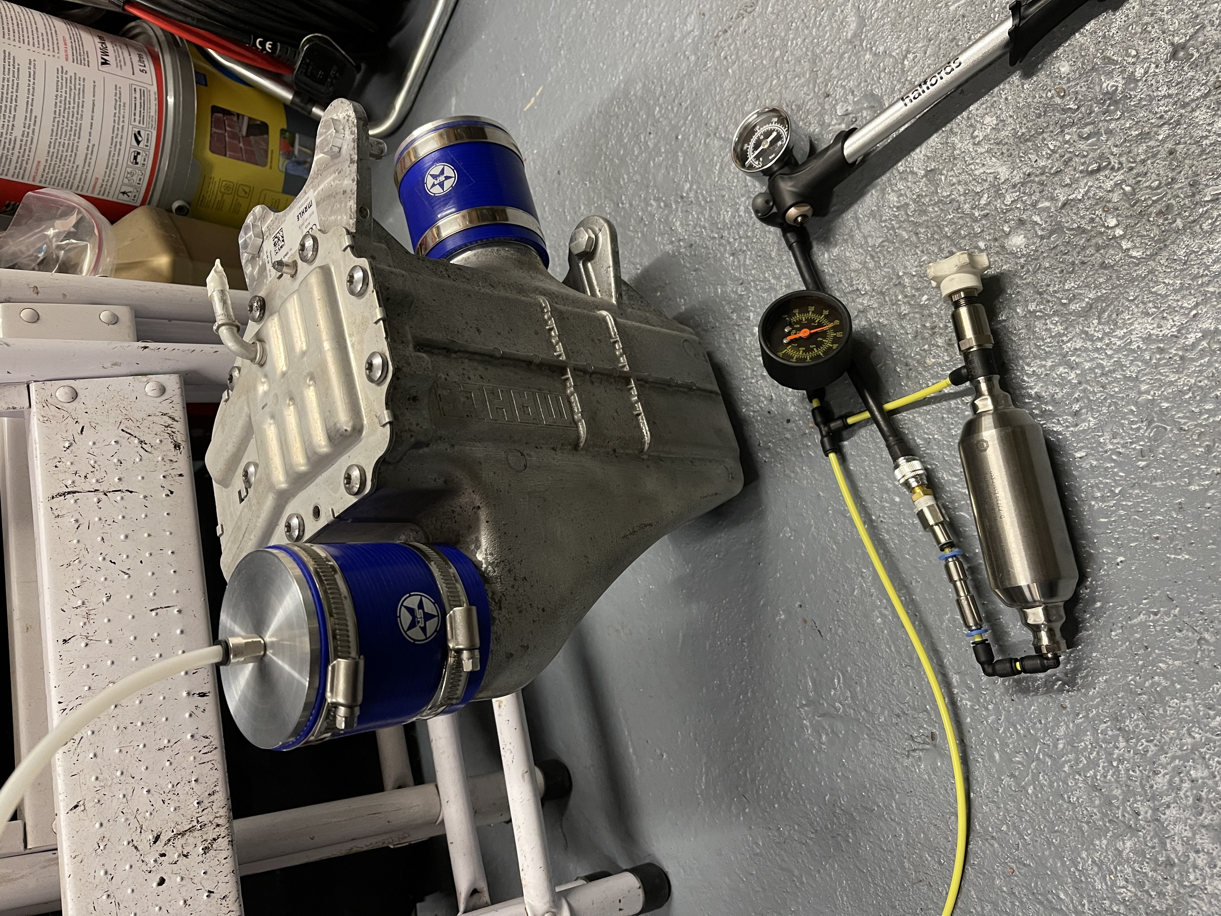

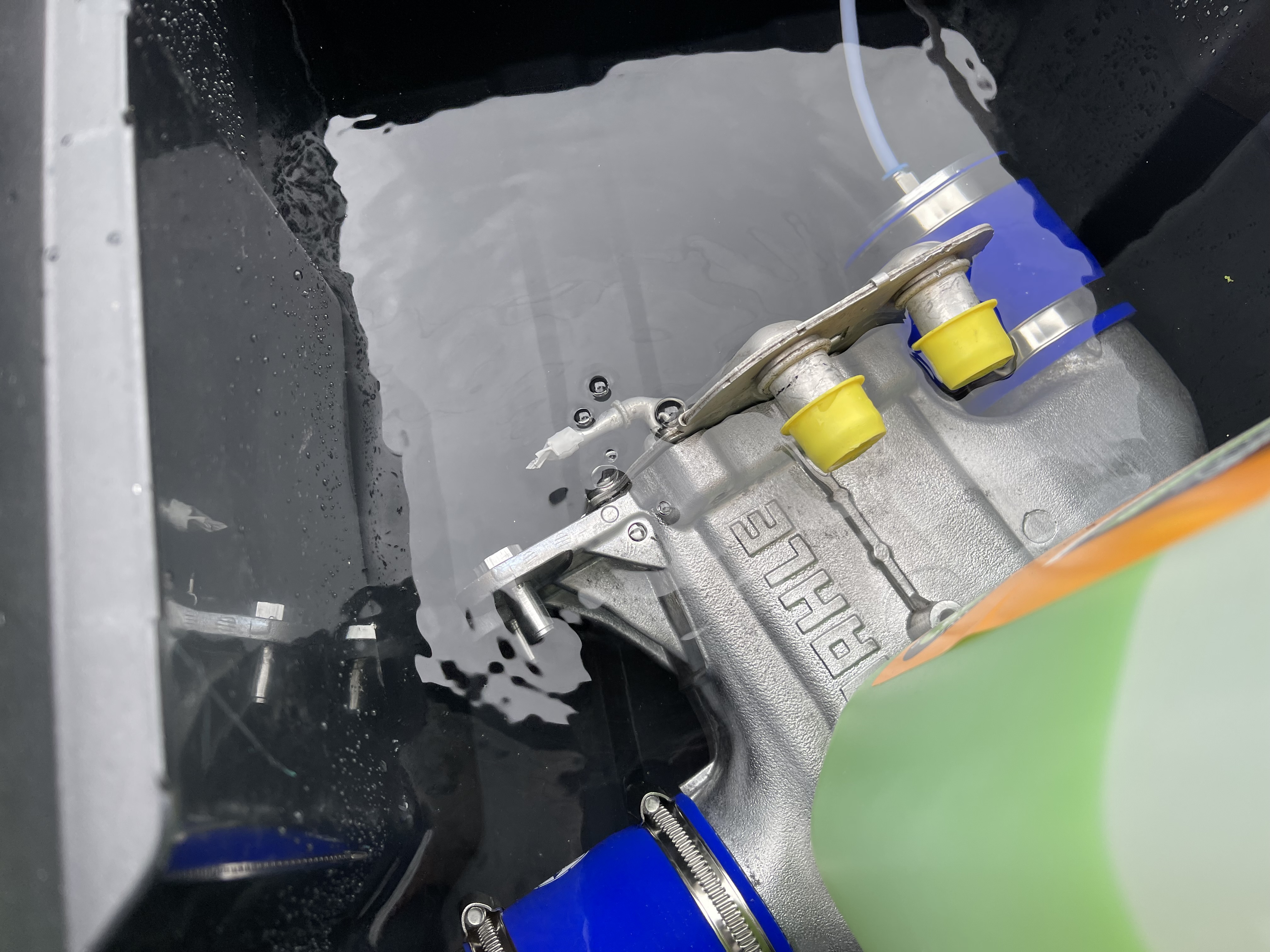

Next I got some silicone hoses and turned up some hose blanks, reassembled the charge cooler and pressure tested the air side.
This did leak a little when I put the whole thing in a tank of water. It took about 15 min to loose air from 3bar.
3bar is the absolute maximum boost I can think the cooler would see unless your going for a stage 2 plus tune maybe.
But a little leak doesn't matter as with the engine running the turbo's will more than make up for that loss.

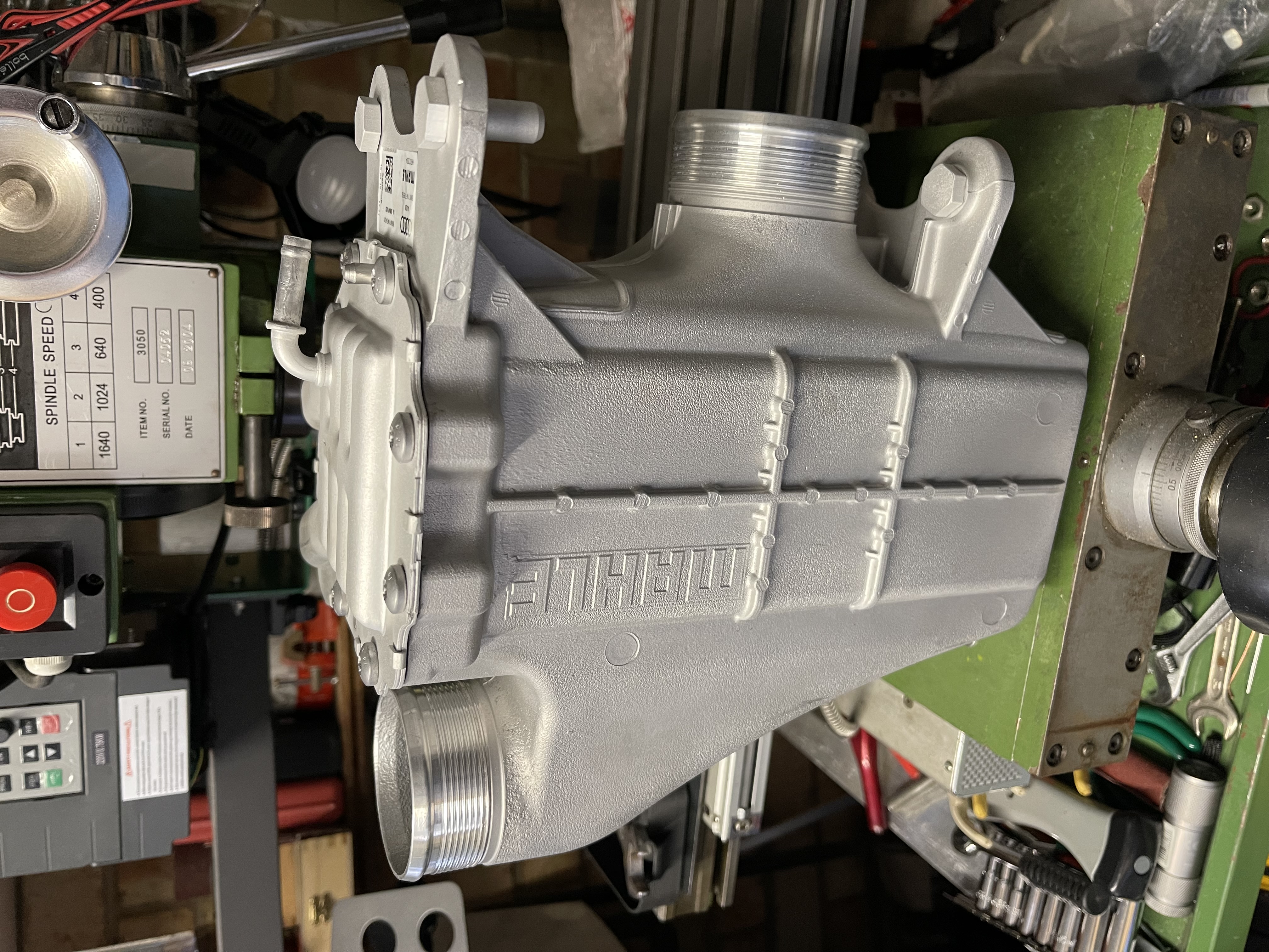

I had to make some charge cooler mounting bolts (you can't buy them as separate items), during removal one was broken and
a second was bent which broke when I tried to straighten it.
Finally I have a friend who has a vapour blaster that I used to clean it up.
