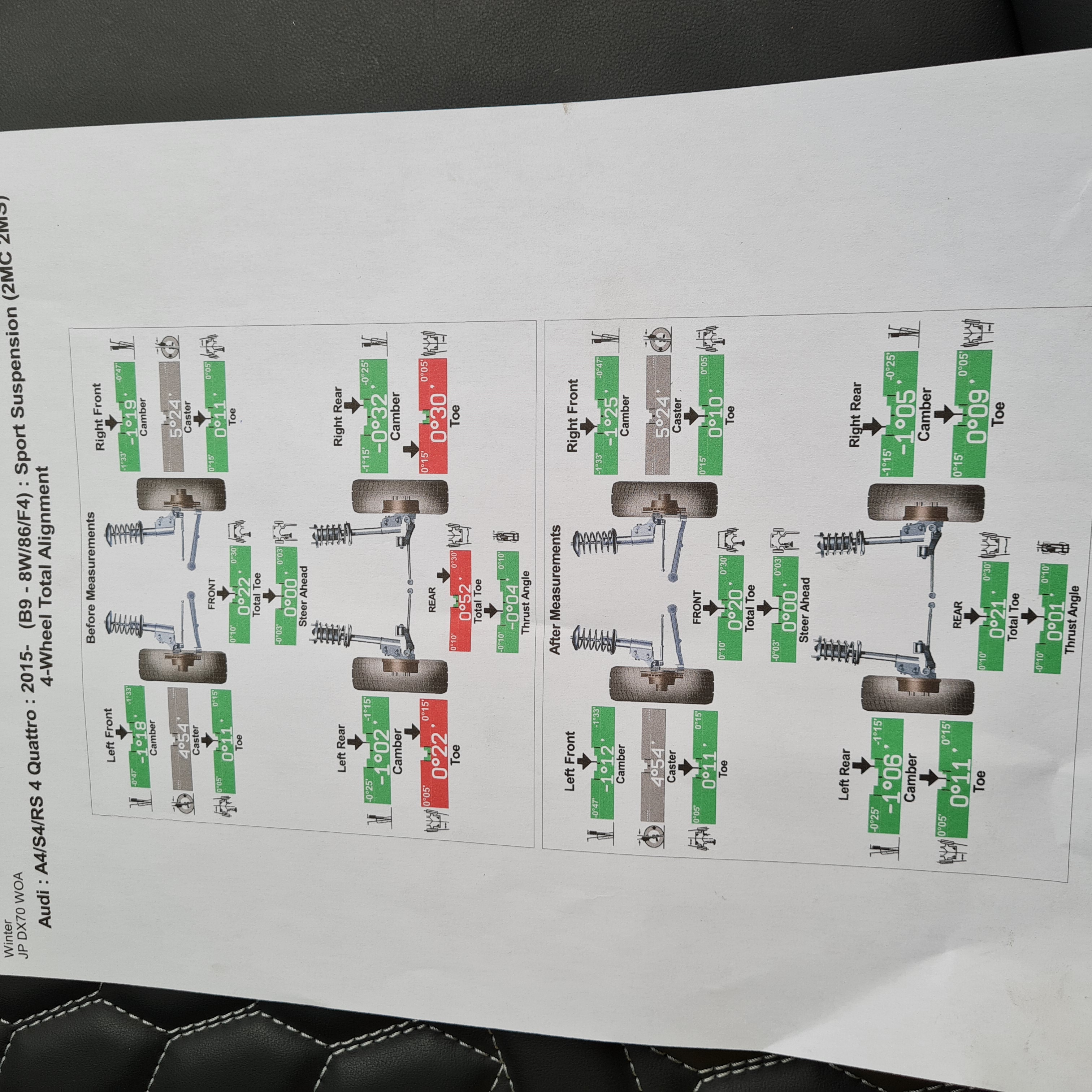

BTW, did you photo your alignment information ?
Hopefully attached sheet they left in car..... doesnt give the limits but does give the settings that are classed as green....
Nice. Appreciated
