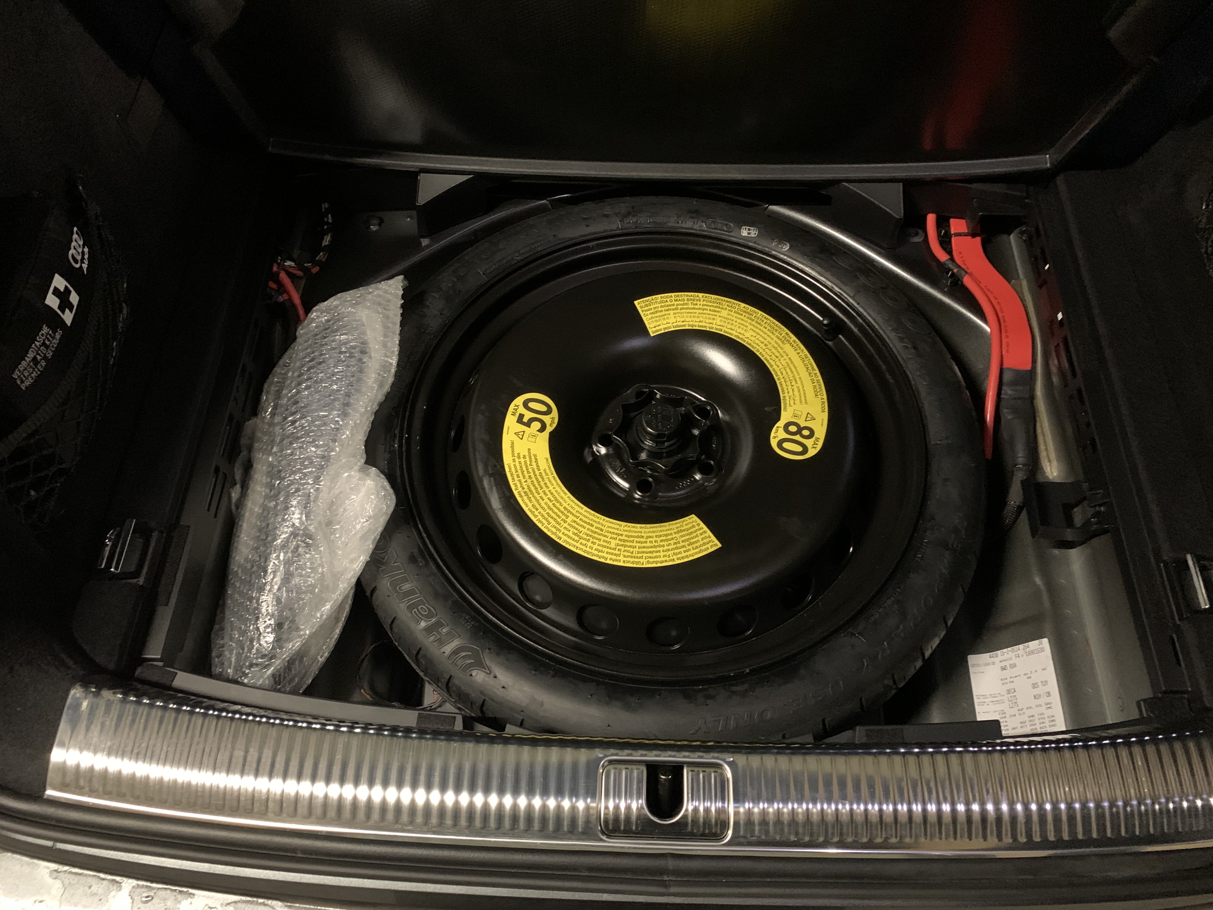

I’ve attached a couple of pictures of my boot with the spare in
I hope this helps

On all the photos above I cant seem to make out the audi part number? The part number is the one that is stamped onto the wheel near the bolt holes. Can anyone take a quick look and confirm the part number please and also list the other spec of the wheel that is stamped there like the ET number.
The only wheel I can seem to find is 8K0601027B with ET29 but I'm unsure if that's the correct one.

I can post photos of my RS5 wheel if that would be any good. I think its the sameDannyboy123 wrote: ↑Sat Nov 14, 2020 9:02 amCan anyone take a quick look and confirm the part number please and also list the other spec of the wheel that is stamped there like the ET number.
The stamps are
- 4. 00Bx19H2 ET22
- PL 244X MWA
- 48 17
- 8W0601027B

Thats great thanks for the info, so the ET needs to be 22. Im sure the RS4 and RS5 will have the same space saver.RS5 Owner wrote: ↑Sat Nov 14, 2020 4:47 pmI can post photos of my RS5 wheel if that would be any good. I think its the sameDannyboy123 wrote: ↑Sat Nov 14, 2020 9:02 amCan anyone take a quick look and confirm the part number please and also list the other spec of the wheel that is stamped there like the ET number.

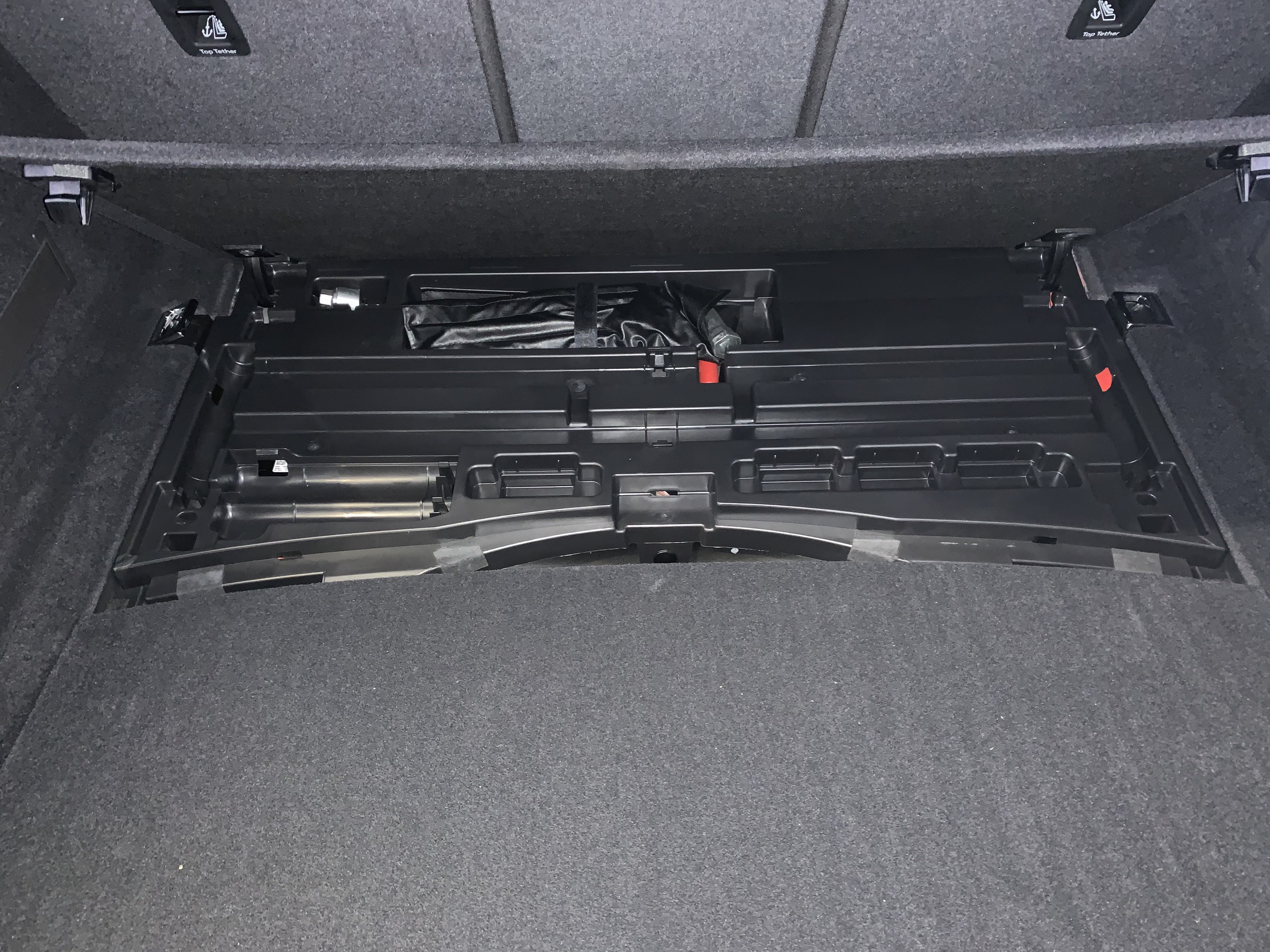

Can some of you from UK kindly share a picture of the other compartment, the one between rear seats and s.w. compartment, so to understand if it is effectively different from the one I already had and a detailed photo to understand how the tools are stored?
[attached my car as of now]

I havent got photos but I bought a compartment from a pre face lift and tried to fit it myself. The dealer is right it will dot fit because of the control modules. I have my jack in the boot next to the spare wheel, like your photo. No other option reallyquattro wrote: ↑Wed Jan 20, 2021 11:29 amThank you Jool, in the meanwhile I bought the spare wheel, and they installed it at the local Audi Dealer.

My dealer fitted a spare wheel to my 2020Dannyboy123 wrote:I havent got photos but I bought a compartment from a pre face lift and tried to fit it myself. The dealer is right it will dot fit because of the control modules. I have my jack in the boot next to the spare wheel, like your photo. No other option reallyquattro wrote: ↑Wed Jan 20, 2021 11:29 amThank you Jool, in the meanwhile I bought the spare wheel, and they installed it at the local Audi Dealer.

B9 RS4. He also tried to fit the difference tool tray to hold the jack / crank etc & couldn’t due to some parts under it. So they left the tray my car came with.
Re the crank / jack. He noticed there was a bag option for the jack / crank. It has a cabana clip. With the crank / jack in the bag we fitted it behind the right hand side recess. That’s the one which has some netting. There a small clip you turn & recess & netting open up. Behind is quite a large hole / recess. We hooked the cabana from the bag onto a hole & the jack / crank fits neatly in there. It’s almost like it’s made for it.

Hi, sorry for a delayed reply. I only just noticed the question.
The part no is 80A862985A
On my receipt it says list price £52.76 which is expensive for what it is.
Here’s a pic of it. I have also attached the collapsible chocks bag. Which was another option I bought.

a Sept 2020 RS4 B9.5 Vorsprung. My car didn’t come with a spare wheel. I don’t think any of the 2020 B9.5’s do. Plus I don’t think there is tray that fits our car. That’s what my UK dealer said.
You can still fit the wrench & locking nut in the tray that came with the car. That comes in the pouch,
Then fit a spare wheel & store the jack & crank behind the right hand storage housing as per my earlier pics
