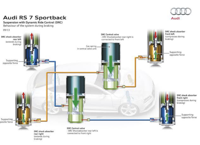

I have something 'similar'.
Several months back I walloped the front passenger wheel - running over a tire stop in car park at speed. (Don't ask).
Apart from the wallop, everything seemed ok at the time, ....until recently I notice the knocking in rear trunk, which I now have learned is one of the 2 DRC Accumulators.
I've been left to understand that affected Accumulator to FR-L/RR-R circuit should be fine, since leak is observed 'at FR-L shock'. The latter needs to be fully replaced according to Audi, not just the hose & connect portion, [and then the circuit vacuumed, filled and 'balanced' to the diametric opposite FR-R/RR-L circuit].
The cause for DRC leak in my case seems different to most, but sharing FWIW ......in case anyone else walloped their DRC shock

If pressure drops, for whatever reason, the valve / accumulator will eventually fail too. So if pressure low and leak / damper repaired you need accumulator too.
