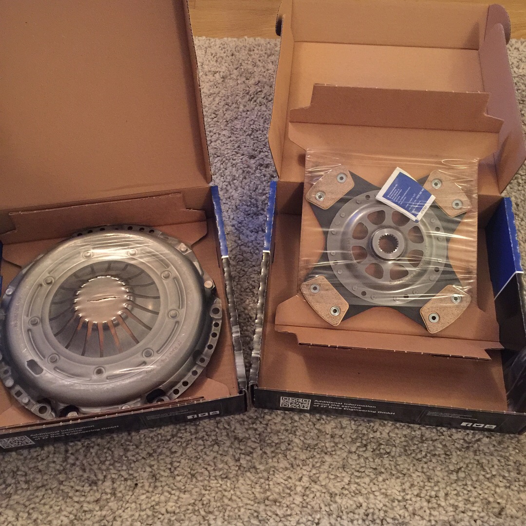

Just to let you boys know i have ordered a sachs performance clutch from awesome gti with the sintered disc, rated to 541 lb/ft and a stronger pressure plate.
So we will see how it goes.

Here it is. hope its not to savage.
Re: Charger build thread
Hope the paddle isn’t too much of an on/off feel
