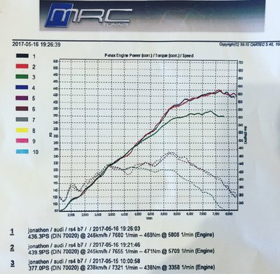

So little bit of an update, picked the car up from mrc Friday. They did a carbon clean, coking was quite bad and was only hitting 377 on the dyno. This was completed with a stage 2 map and we threw on a inlet manifold I picked up off a member, the manifold had been worked to the equivalent of a mrc stage 2. Doug actually said the quality of work on it was really good so thanks Luke. He was expecting better numbers but we got 439.9ps so I am happy with that.
I had planned to have a crackle map with launch control mapped in also but Doug wouldn't do it with the original cats been on the car. The cats would catch any spent fuel and end up melting. The exhaust needs to be done anyway so I'll look at the soon.

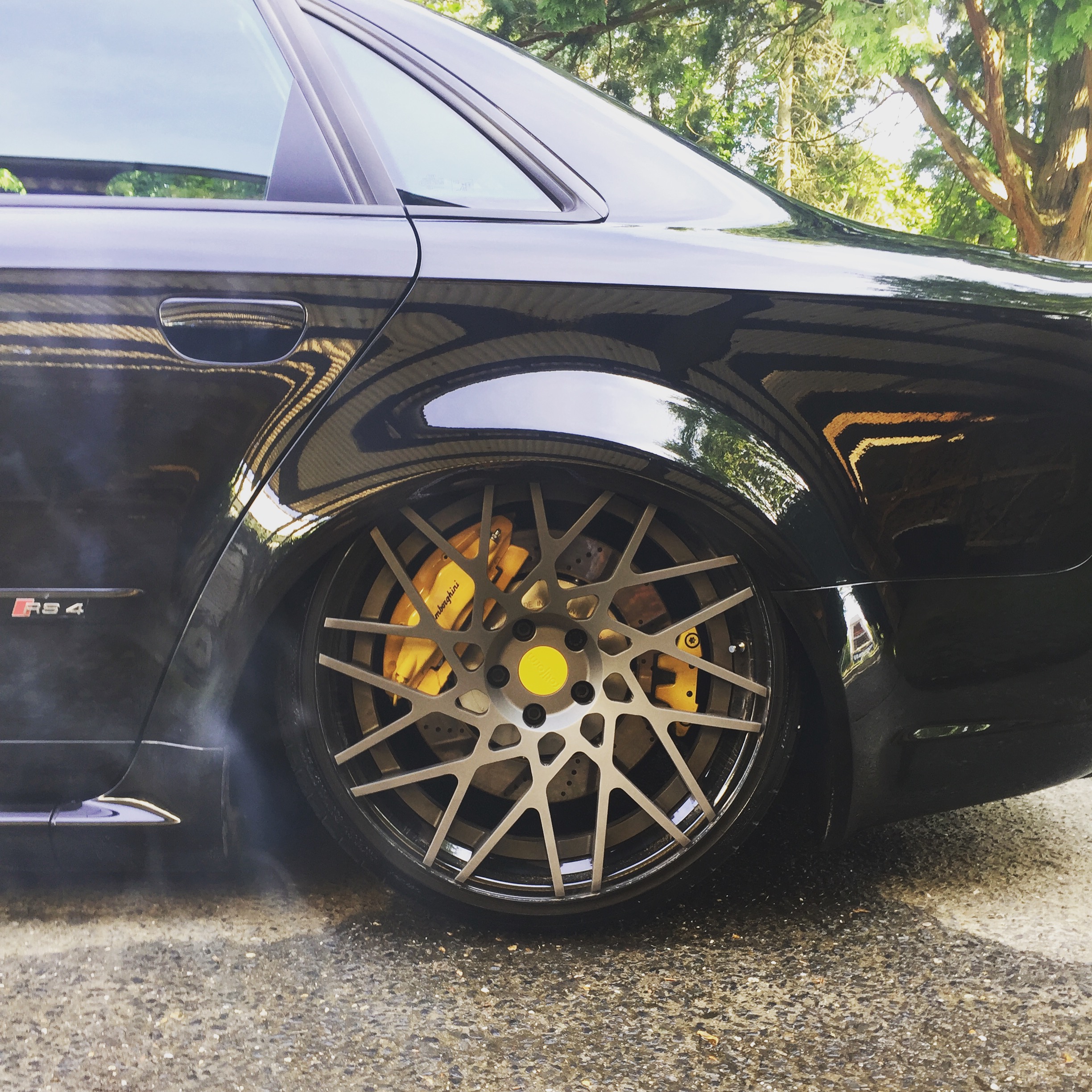

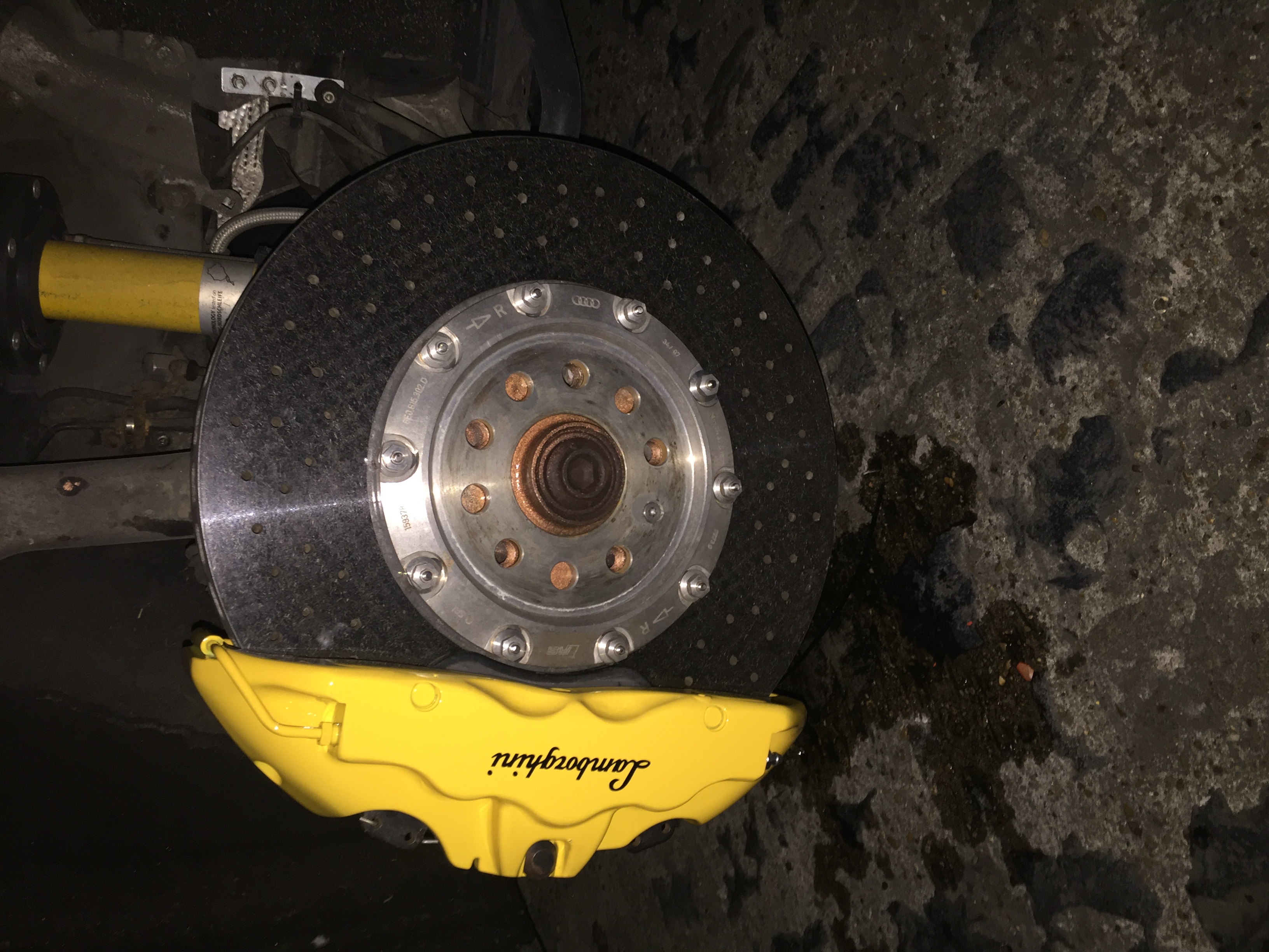

The rear brakes were fit but either they were not familiar with the adaption kit from still static or the part was not there but the rs4 cable could not be fit with the r8 handbrake calipers due to the fitting on the end of the cable. I have spoken with the supplier and I will get my hands on the bits when I get home.

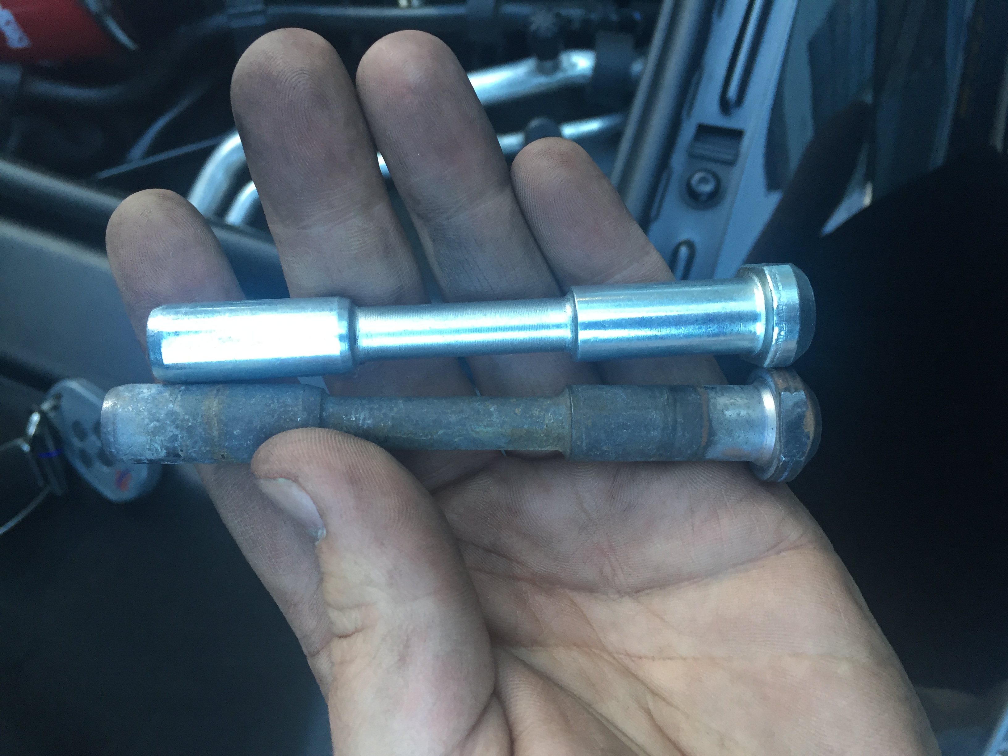

The front calipers were fit by myself due to the wrong pins being supplied from the refurbishment company. There was a new kit supplied but the pins were 9mm too short. I ended up getting a same day courier to get them so I could fit them before heading to worthersee.

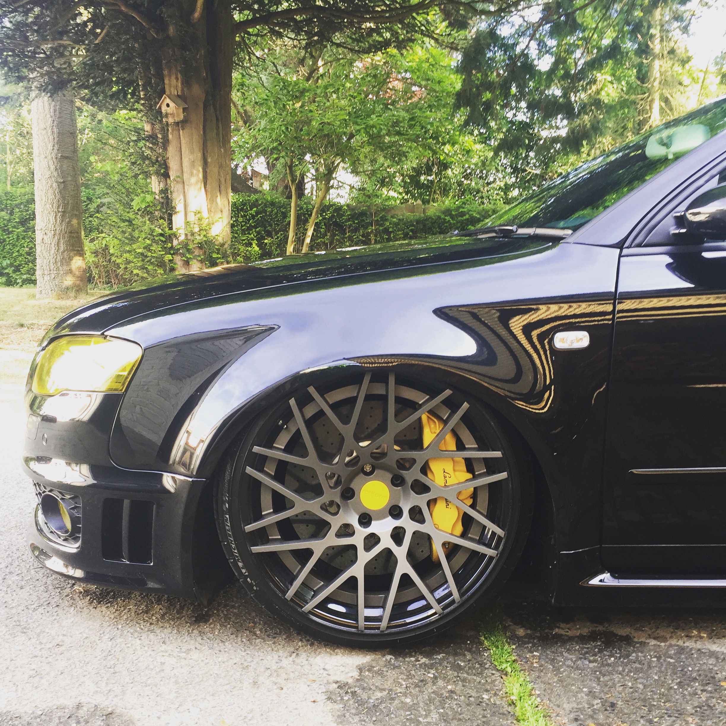

Anyway they are on now although with the stress and trying to rush the job I have fit the upside down.... I know I'm an idiot. I don't see a massive issue with it though. The pads still seem to sit centered and braking is excellent. I had the car on the Nurburgring yesterday and these things are amazing even if my driving is average. Haha.

Car looks great!
Interesting numbers with a stage 2 manifold, I made 430 with all the flaps in place. I thought it would be near 450 in your spec
Re: Jonys RS4 Project
Standard exhaust.Rw@@dy wrote:Car looks great!
RS4 B7 aka Vinnie
RS4 B7 aka Vinnie
I made 447 with flaps in place and no cold air feed, flaps out now and 2 horses more.

Doug was actually surprised and was expecting more. He put it down to the fact that these cars are just getting older now. It's not the end of the world. I'm really happy with it, it pulls really hard now. Once the exhaust is done I'll get him to tweak the map but by then there will be more carbon build up so probably will see less power anyway.
