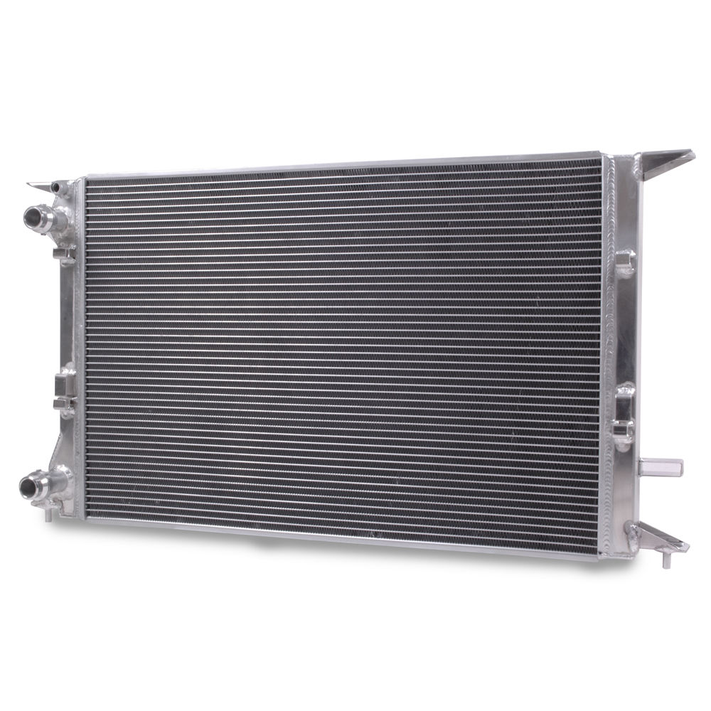

Something like this would be my intension. £79.
Getting the dimensions of the Forge etc item or even the RS6/7 radiator would help hugely but I doubt I will find that info any time soon. Will have to rip off the bumper and do some measuring I guess

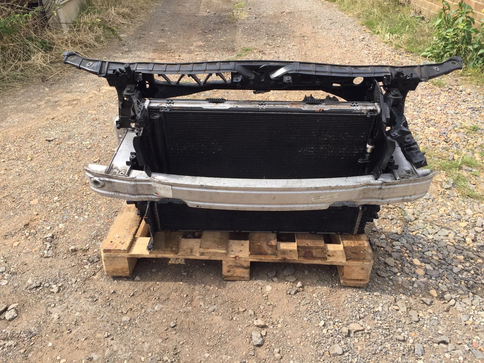

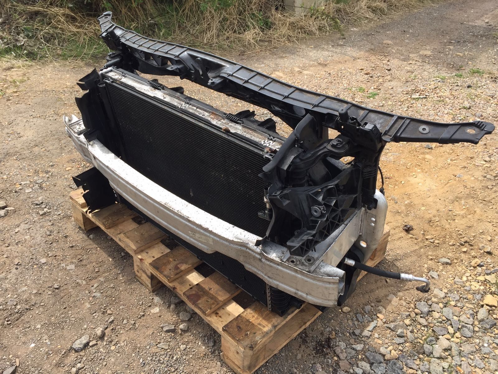

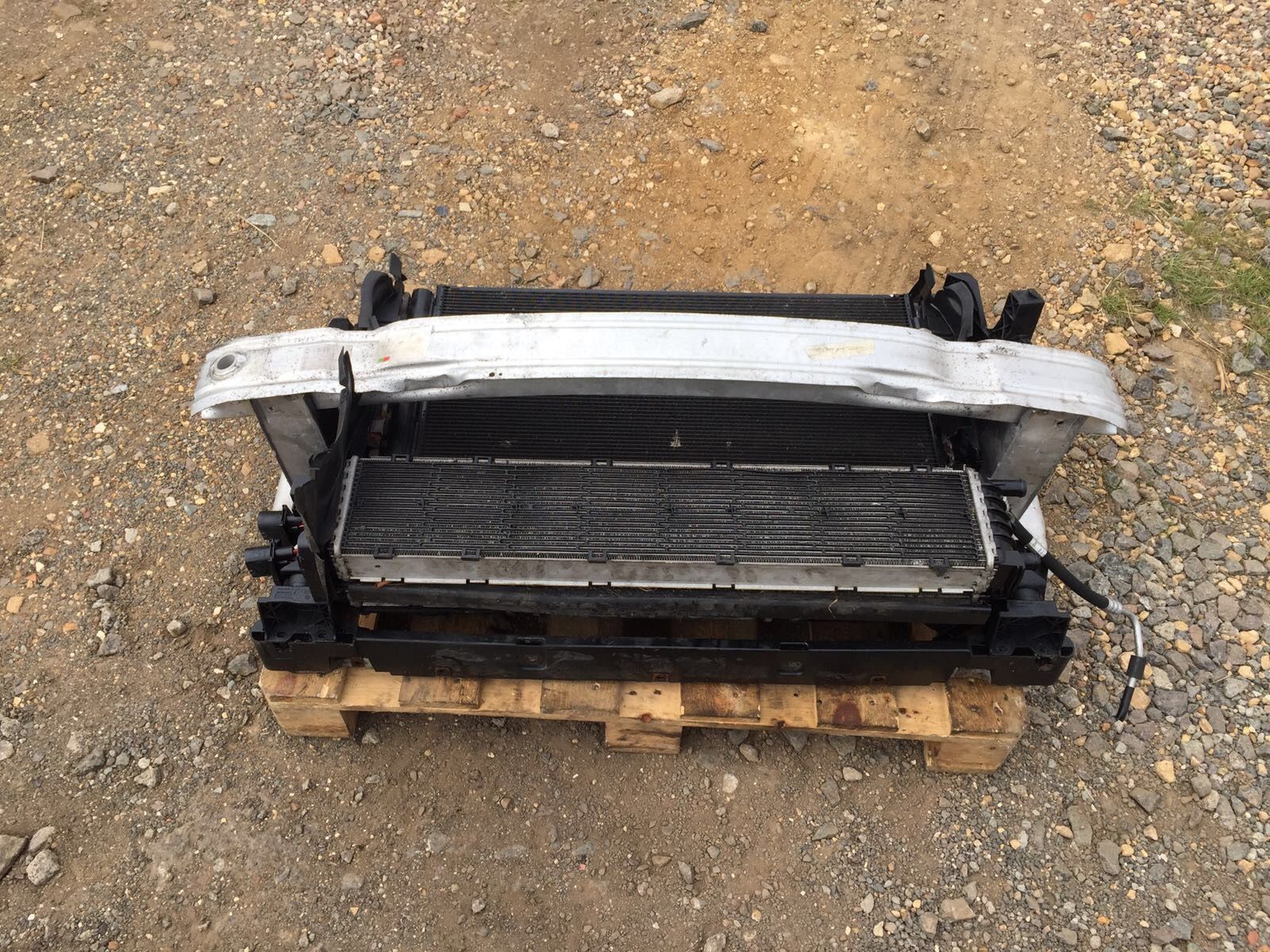

Found more interesting information. Not sure I will bother with bigger radiator for the current charge cooler. There is a massive amount of room for a proper Air to Air intercooler. I know Water/Air is more efficient but trying to increase the size of the current cooler or adding a second cooler (M5 has 2 charge coolers) would be very time consuming and expensive.
From what I have read the current set up (with bigger radiator or not) max is 800bhp. Charge cooler is tiny I am surprised it can cope with that amount of flow.
Getting 2 inlet manifold connection fabricated should not be that difficult then the rest is just piping and the biggest cooler I can fit in that space. While typing I have just convinced myself this is the way forward lol
I guess the stumbling blocks will be, routing the pipework through to the intercooler and back, pipe size big enough to cope with the flow but small enough to allow ease of fitting, deciding where to joint up the 2 turbo feeds into 1 before the intercooler and then back into 2 again to each side of the engine OR use 2 smaller intercoolers one for each side of the engine / turbo.

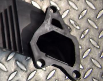

Pics are inlet manifold connection and front end off a C7 S6
Anyone know the part number for the inlet manifold pipework??

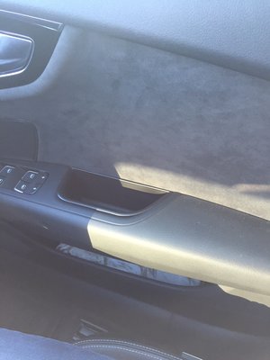

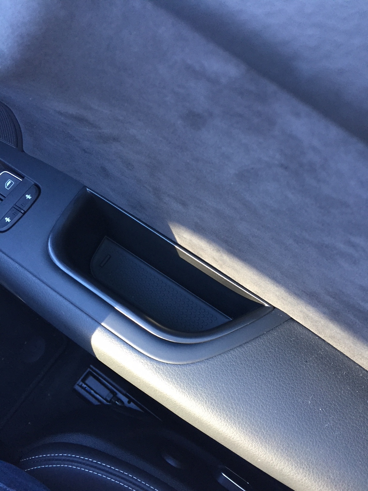

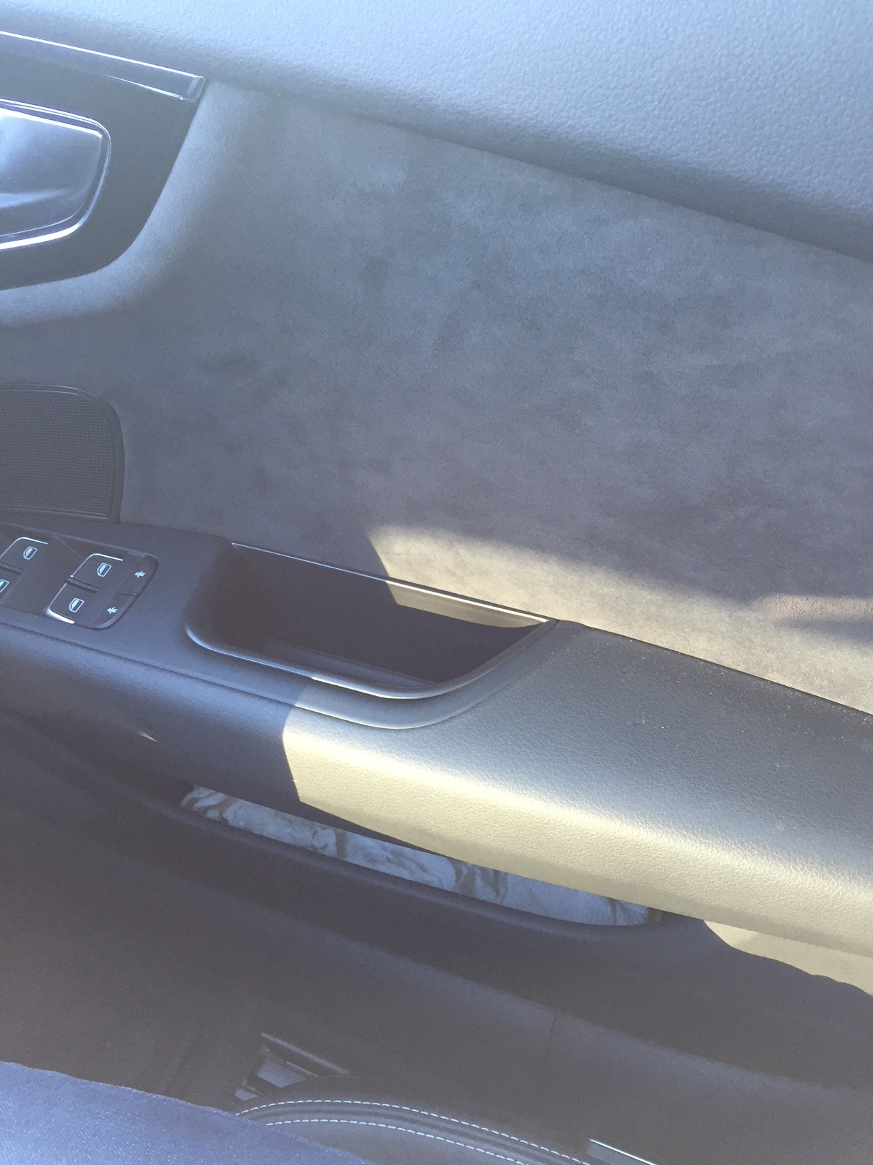

new mod today. cheap but very handy. perfect fit and even look oem.
