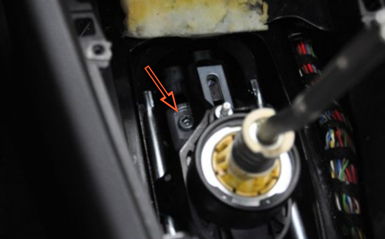

Have a long Hex T handle driver ready to use for the two lower bolts. You will see that its slim profile gives you more room and a straighter purchase on the bolts than a socket with extension. Something like this:
Before you remove the top hex bolt of the original OEM shifter scrape a mark around the position of the bolt and its washer. This is critical so you know exactly where to replace that bolt. I used a small screwdriver to make a curved scratch around the washer. Upon refitting there was no guessing the correct position. You can see the bolt and washer in this picture:

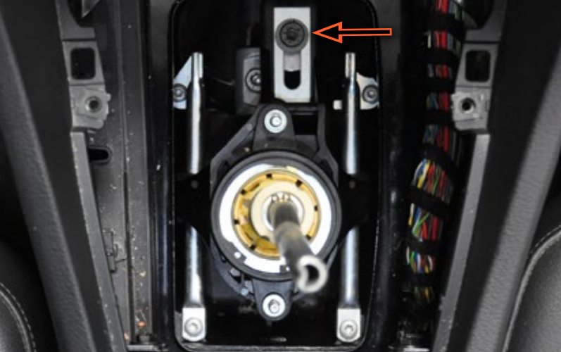

The hardest part is trying to get the lower bolt and its metal curved clamp piece bolted to the main shifter rod. The location is so low down that they keep falling into the bottom as you try to position it into the screw hole. A magnetic pick up tool is a must and lots of patience. I won by ensuring the hex bolt was securely gripped\wedged into the Hex tool with tissue paper so I only had to focus on the metal clamping piece.
Now here is the issue that makes it tricky to screw that bolt in to the selector rod. The low L shaped part of the shifter (black thing in the first picture above) is free and moves up and down. When you line it up with the shifter rod which is also loose, to make ready to bolt together, both pieces are at a slight angle to each other. So when you try to engage the bolt from above, it wont thread and start into the hole. I wasted an hour trying. The L shape part needs to be simultaneously "lifted" up so its horizontal. Only then can you thread the bolt. Use a wire coat hanger shaped to cup the rods from below, and with one hand lift it up whilst at the same time with the other hand turn the hex bolt tool to get it to start into the thread.
Once this is done your on the home run and can follow the instructions and adjust the position of the gear lever, and its height.
