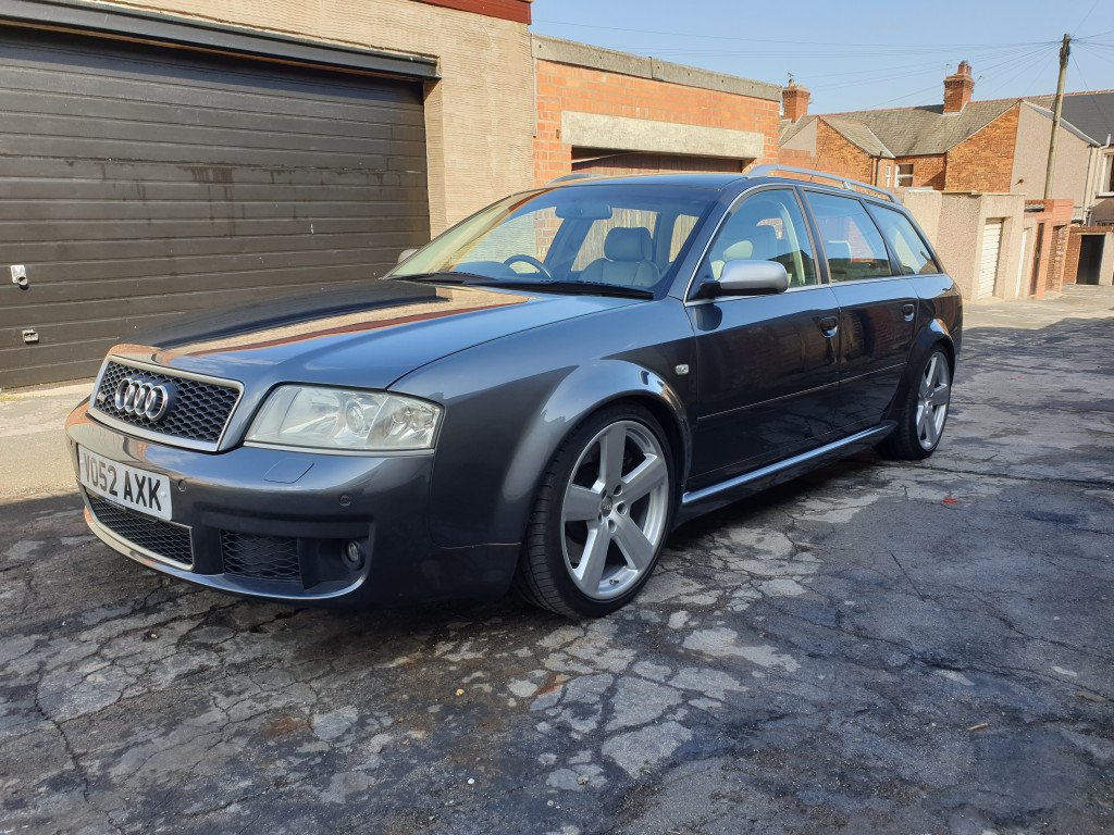

Hi,
I've posted in the New Members thread ( viewtopic.php?f=18&t=132558) but I wanted to start a post in this section now that I have fixed a couple of issues, lowered the back end and given it a good clean.
I had fancied an RS6 for a few years and this came up locally so I went an looked and a deal was done. 67k on the clock, FSH including gearbox services, etc recent cambelt and coilovers. Perfect to transport kids and the hound places. No real plans to modify other than upgrading the stereo as I need a family car and because I also own a 600 BHP Audi B5 S4 saloon (ASBO chariot) which is just insane and not an everyday car :shock: . I am also restoring my santorin B5 S4 saloon which I ve owned for years.
So far ownership is going well thinking of going to Unit 20 for a health check in the near future for peace of mind and I will fix any issues they may find.
