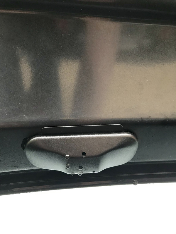

Hi folks,
My windscreen washers have annoyed me since buying my car and when I used them, the far one on the left watered the verge or sprayed the pavement. Rather than adjust them I decided to look into replacements an it was either tri jets or fan jets and I went with fan jets.
The part numbers for the jets are 5M0955986C and the shims are 8E0955431. These are needed to fill the gap as the washers are slightly narrower. Very easy to adjust with a wee screw, I have set them in place but may need adjusting after testing at speed.
Cheers :thumbs:
Re: Frazer’s B7 RS4 Avant
Post by MikeFish » Fri Mar 01, 2019 11:46 pm
Can't tell from the photo, but it looks like the triple jets?
Surrey Sam
Posts: 4195
Location: Sussex
Post by Surrey Sam » Sat Mar 02, 2019 12:09 am
Not the tripples. Looks like later C7 A6 ones which are a cross between mist and spray pattern.
They are Volkswagen fan jets, still playing about with them but I’m happy with the results.
Cheers :thumbs:

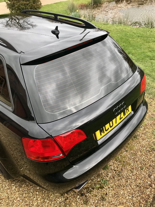

Hi folks,
My rear wiper delete turned up through the week from kill all wipers so I fitted it over a couple of evenings after work and washed it this morning. Very happy with the results. I will leave the rings on for now to see if I like them without the rear wiper but I might end up removing them.
Cheers :thumbs:
