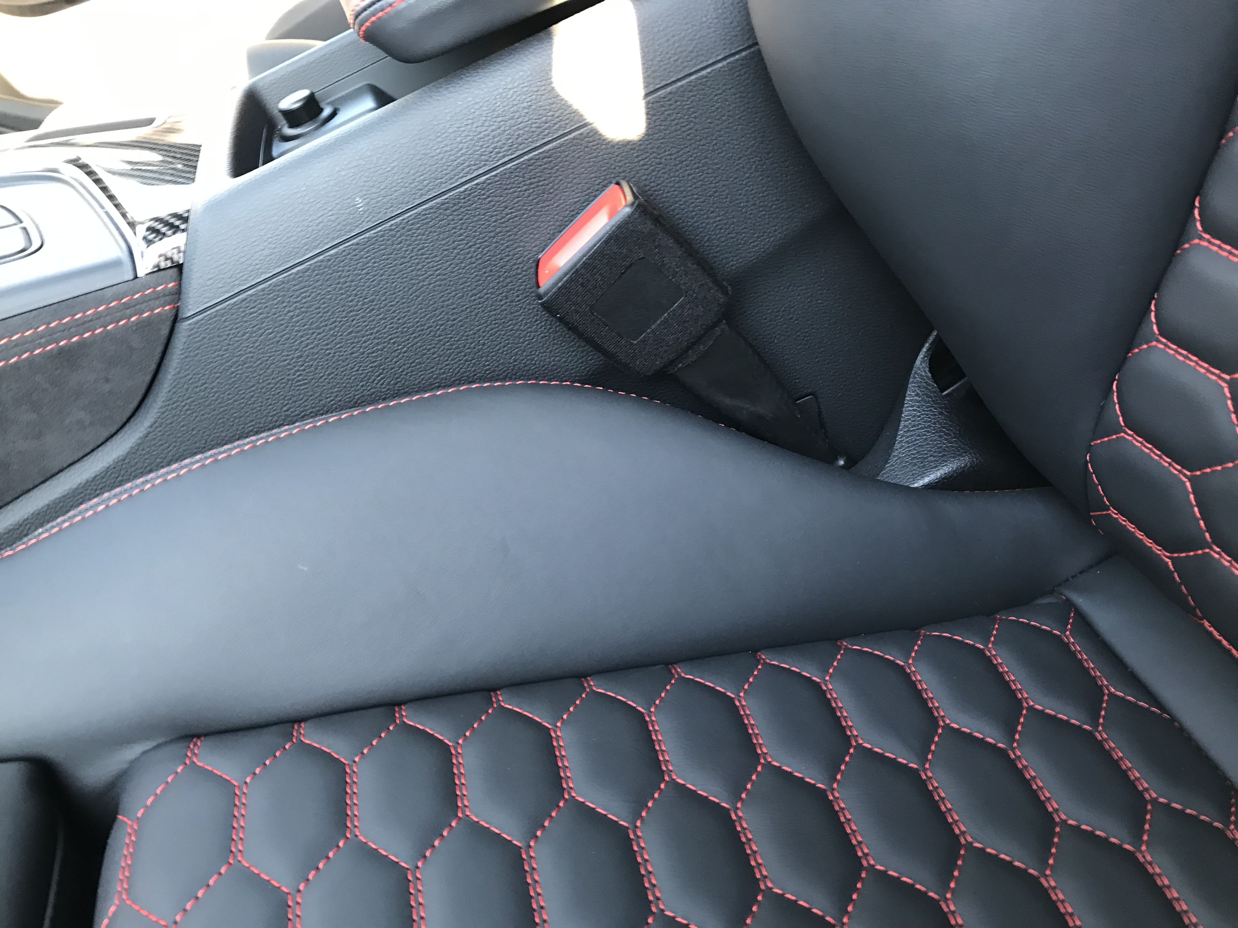

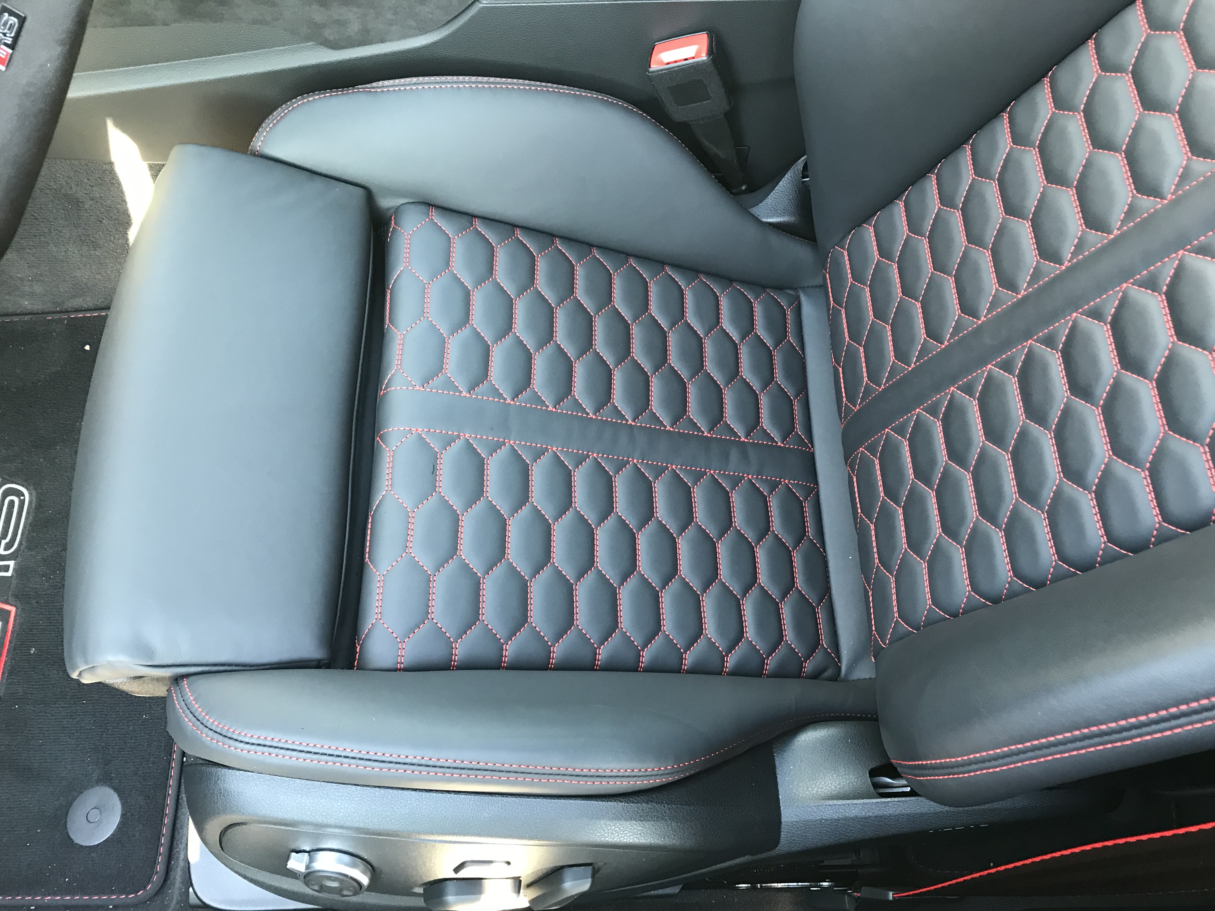

Well, I have had my first issue with my RS4... Aaaarghh!!!
The driver's seat has some damage to the stitching due to wear from the seatbelt fastner.
The point of that fastner rubs on that spot resulting in damaged stitching and some rub marks on the upholstery.
The passenger's side one is mounted in a steeper angle and completely misses the leather upholstery when it flexes.
It sits higher.
I ADVISE EVERYONE DRIVING A B9 RS4 TO CHECK THE FASTNERS.
I was at Audi Zentrum Leverkusen, they had one RS4 left in the showroom. That one had the same issue.
The good news is that Audi is willing to replace it under warranty.
Really daft that this happens, it is caused just by a sloppy mounted seatpart...
I include some pics of both seats, driver's side first last is the passenger side (LHD car)

Good spot. I’m assuming you were cleaning when you managed to find that. Glad you have got it resolved, are they replacing the whole seat or taking it to bits?

Post by PieterZ » Thu Sep 20, 2018 11:02 pm
Yes indeed. I was not amused...
Only the seat upholstery will be changed. It is on backorder though.
No need for a complete new seat.

I had my damaged seat fixed on wednesday.
The mechanic managed to adjust the seatbeltholder so it doesn’t rub any more. They also added a protection piece that is standard in an A3. Just to be sure.
I’m happy with the solution.
It was covered by the warranty.
