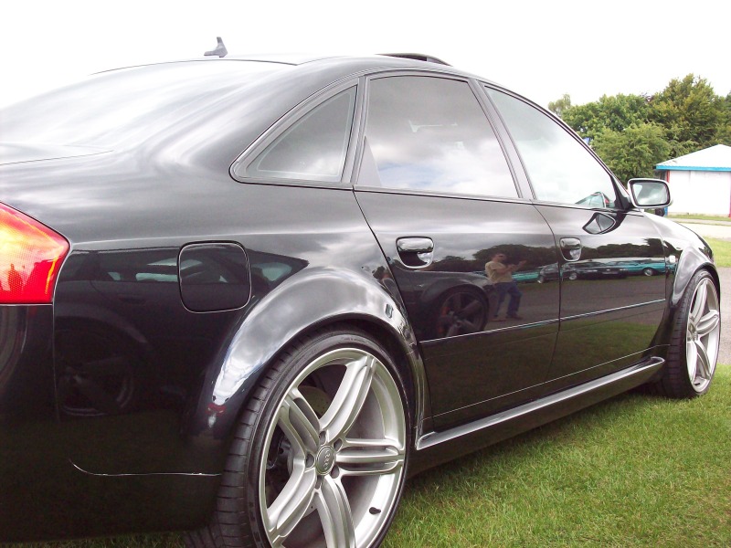

Im wanting to upgrade my 17" OEM alloys to 19" but can't get my head around what offset is required.
The 17" i have are 255/40/17 on an 8" rim width and 35 offset. But these don't sit far enough out in the wheel arch so was thinking of getting a 255/30/19 on 8.5" rim width but get confused on what offset to get the new wheels in to fill the arches. I understand im gaining half an inch in the width but do i go up or down on the offset to stick them just on the edge of the arch?
This is the look im after really
http://forum.rs246.com/download/file.ph ... &mode=view
Any help would be greatly received as i dont want to get the wrong wheels!! :thumbs:
