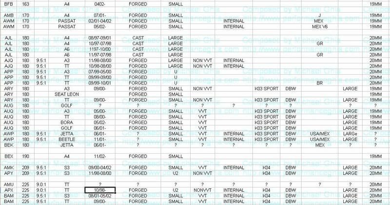

no point trying to buy a BAM engine if you are looking to rebuild it anyway. they go for almost twice the price! lots of other big port engines
is this being dropped into your existing S3 or another car? if the former and you have all the ancillaries and manifolds then you can buy ANY 1.8t.
your issue comes on how much work you want/plan to do on it and whether you want big or small port head, 19 or 20mm wrist pins, forged or cast crank.
if you are planning big power there are lots of parts of the stock engine you should look to replace anyway (rods, valves, springs for a start), pistons are bulletproof as is the crank, crank gear keyway is a weak point so look to get it dowelled/pinned.
engine choices and specs below:
courtesy of mike ghia clubgti

BAM isn't a large port engine, its a small port.
The reason they sell for a good bit more than some of the other more common version of the 20vT engine is partly due to being fitted with a K04, larger injectors, lower compression etc, etc.
