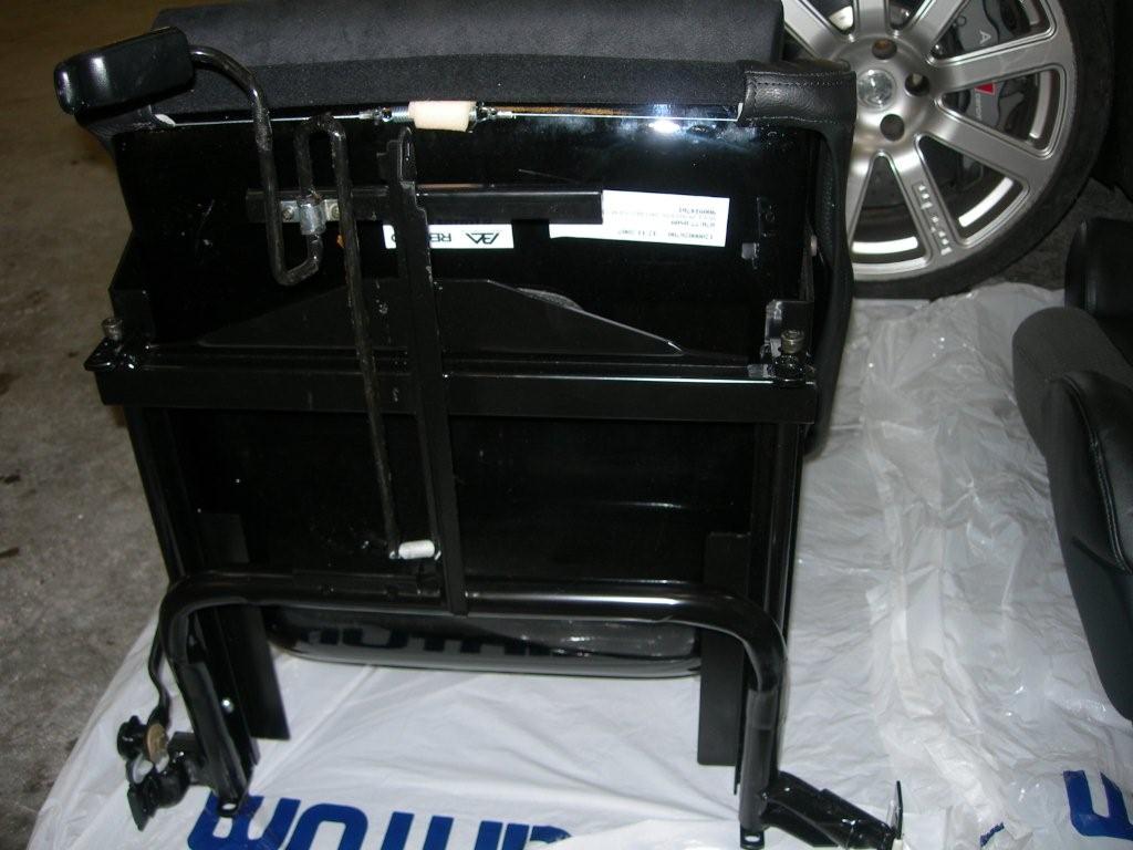

Hello guys, i did received my pole position seats last week but with the wrong rails :evil: Same story.....Anyway i will get the right parts very soon. Is anyone on this forum who have the same seats fitted on his car would be king enough to take some pictures ( rail fitting area under the seat) so i can have a good idea how and where the parts go.

some pics:

you do need to remove the front to back adjuster handle from hte original seats. In the top picture you can see hte nadle nad metal bar it is connected to - you can jsut see the silver bracket that holds that onto the frame - 2 screw hold that on - then the spring ath te back of the handle needs swapped over. That is all you need to "modify"

you do need to remove the front to back adjuster handle from the original seats. In the top picture you can see the handle and metal bar it is connected to - you can just see the silver bracket that holds that onto the frame - 2 screw hold that on - then the spring at the back of the handle needs swapped over. That is all you need to "modify"

Thank you so much Doug , wanted to ask you about that but i do know you are very busy in your workshop. Top man you are. :wink:
Yeah i had to wait 2 months before to get my seats.....and at capital seats they seems not to know their products at all.....Been told i will have the right rails on the 8 th next month. The seats look really nice and i can't wait to fit them.
