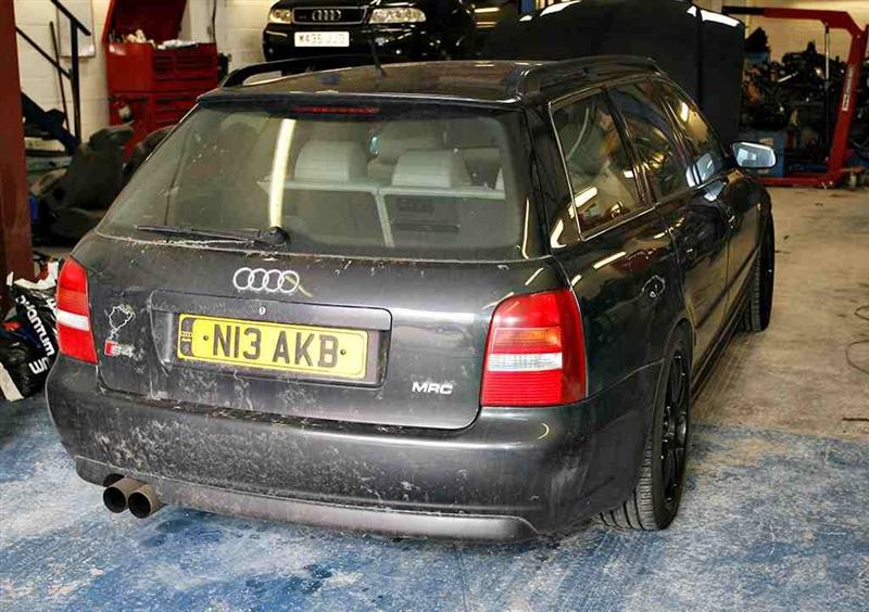

Post by Ads4 » Thu Apr 17, 2008 11:11 am
Did you get anywhere with this Jimbo? Looks like I've got the same problem.....
Milltek 'fluff' (Medium).JPG (88.79 KiB) Viewed 2226 times
Adam.

Post by jimbo1234567 » Thu Apr 17, 2008 6:56 pm
i sent them an email twice last week with no reply :thumbsdown:

Post by Doug_S2 » Thu Apr 17, 2008 8:11 pm
most cars with power around 500 are blowing the wool out.
