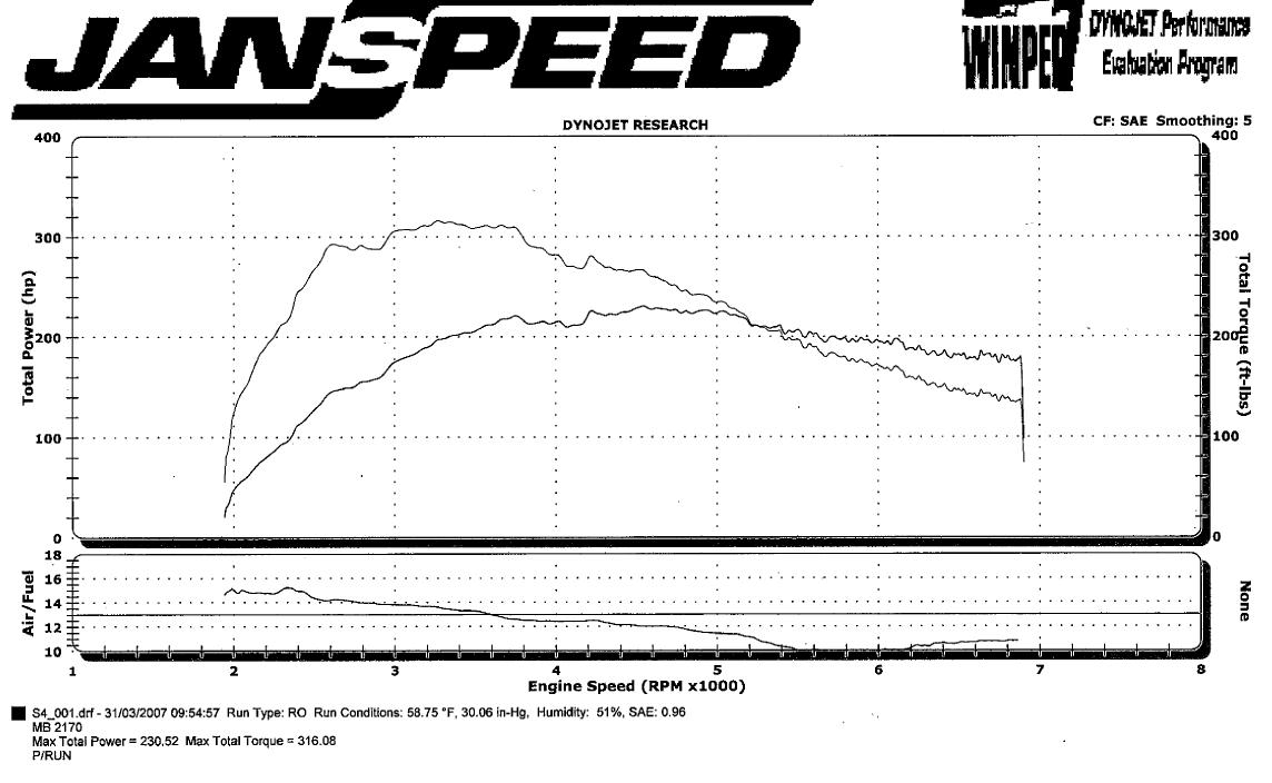

In the next month or so I hope to get my RS4 downpipes and intercoolers fitted.
At the weekend got a bench mark power run that showed Max power at about 4.5K RPM The car also went rich over this point so may have been limiting the top end power.
What I'm wondering, will the better breathing help lean out the top end?

Just seen GrahamS4's power figures with just a remap. Now I'm not happy :( 250bhp and 360 lb-ft @ wheels.
Unless this map starts to work much better with the new parts fitted I think its time on the car is numbered!

well mine saw 385lbft torque and 233ish at the wheels so i think its time it went also..that was with RS4 coolers but S4 dwn pipes gutted..

Is it a characteristic of the Dynojet dyno or is your power curver very "bumpy"?

Post by MarkB » Tue Apr 03, 2007 12:03 pm
I think it's just not smoothed. I think the others on the day were similar, but can't be sure
