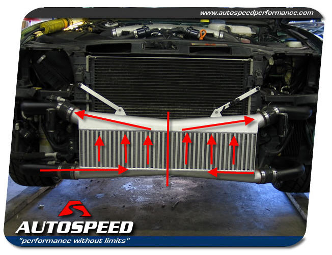

Then there is this excellent looking peice of kit, due out in Feb...
S4B5 Avant

MCB wrote:Then there is this excellent looking peice of kit, due out in Feb...
Be careful ofthe full system, you will need to re-locate the oil intercooler and remove or replace with smaller air-con fans.
Will get back to you on these systems later.
