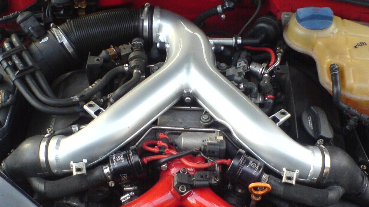

Post by s4woody » Sat Dec 02, 2006 2:04 pm
i took my vaccum from the fuel pressure regulator on my engine..
if you look at the picture you will see a small red hose to the rite..thats it..
Picture 441.jpg (111.91 KiB) Viewed 800 times

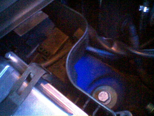

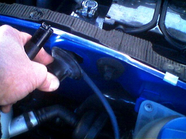

Post by shineydave » Sat Dec 02, 2006 3:34 pm
pics of the pipe routing from inside the ECU housing to the T piece. i pulled the grommet in the bulkhead out as it was easier to cut the nipple off and pass the pipe through it with it out.

Post by s4woody » Sat Dec 02, 2006 4:42 pm
that grommet next to the grommet you have pulled out dave is where mine goes through to the ECU box.. i just cut a slot into it and passed it under the ECU loom then into the ECU box then along the underside of the dash and into the centre vent..
