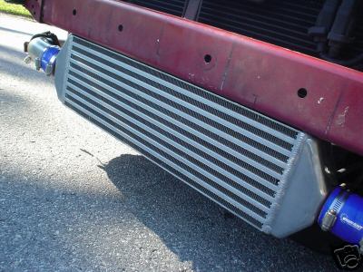

Anyone thought of buying 2 of these shallow intercoolers and mounting them on the front of the car ( behind the bumper obviously). They would work 1 for each turbo.
It would need to be measured carefully and prob not the one shown, I used it just as an example.
It would mean the left turbo would feed into the right side of the inlet and vice versa for the right turbo. I can't see why this would cause any probs as all the charge air ends up in the same place at the end of the day.

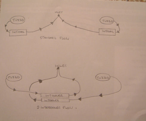

Paulm
Posts: 1661
Location: Aberdeenshire
Post by Paulm » Sat Mar 04, 2006 10:59 pm
this is what i mean. yes i know i should have been an artist :lol:

s4woody
Posts: 3764
Location: surrey.
Post by s4woody » Sun Mar 05, 2006 12:36 pm
thats a grt pic but the bottom pic shows a single ic but with twin inlets /outlets..the original pic at top show 1 inlet/outlet..thats the type i think mite cause probs..not the twin inlet /outlet version.. :redrs4:

He ment 2 small ones on top of each other , one wound feed in at the bottom left & out on the bottom right . The other would feed in top right & out top right . cheaper to use 2 i/c's than one big one . woody , i think that you pic is for a 1.8t a4 . Intercoolers have been coverd before . i've spent several hours on the phone with 'pace' , they should have started on s4/rs4 i/c's in early jan but they were trying to finish off the bmw mini at the time .I'll call them on monday..

Post by s4woody » Sun Mar 05, 2006 3:38 pm
cheers grizz i must admit i missed the bit that said 2 of these..im such i div.. :bash: sorry paul.. :redrs4:

Post by Paulm » Sun Mar 05, 2006 4:17 pm
Yeah thats what i meant grizz
no prob woody, just thinking out loud really and had a few beers into the bargin.
fade, I dont think there will be a great deal more pipe work. It looks it on my drawing but it is pretty crap really. I read a 40 or 50bhp gain in FMIC, this seems a bit high to me but you never know.
