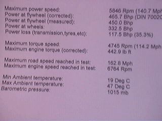

Well I'm back from AMD. Very pleasant bunch of guys, one has even asked me to join his cricket club when I move up that way. The results are pretty satisfying, headed over to Gloucestershire cross country and despite the weather and a woman sitting next to me, had great fun. Milltek is, if I'm honest too noisy for me at 2,00rpm, but I'll live with it...
Figures are thus:
Power at flywheel STOCK: 386.8BHP @ 6183 rpm
Torque STOCK: 348.8lb ft @ 4346 rpm
Power at flywheel MODIFIED: 465.7 BHP@ 5846rpm
Torque MODIFIED: 443 @ 4745 rpm
Overall - very pleased, I can scan plots if anyone is interested. One thing I did notice was that the modified torque plot is more 'up and down' compared to stock. They began to explain why - Haldex, power shifting from front to rear, perfectly normal plot etc etc as my eyes glazed over...
I think what is as pleasing as anything is the figures at stock. They signified a very healthy car which is always nice to know.
So far so good, and well done AMD. I have to stress that I really chose them over Minhea because of their geographical location, as I'm moving up that way.

I'm puzzled -
What do you mean by 'Stock'? And 'at the flywheel' or 'this is what we think your car has stock, but we don't know", or did they put the engine on the brake?
Haldex??????? this is an RS4 we are talking about?
the reliable figures to work with are:
1. measured torque at the wheels before tuning, and thus derived bhp at the wheels.
2. measured torque at the wheels after tuning, and thus derived bhp at the wheels.
anything else is pure supposition.
Ask the guys for the plots corrected only for temperature and humidity, excluding the drive ttrain losses, then you have a sound basis to make comparisons.

Is it correct that you've had a full Milltek exhaust and a remap and you car has gained 79 BHP and 95 lb/ft ? I'd be interested in your Wheel HP before and after.
Haldex is the controller fitted to A3/S3/TT/Golf four wheel drive systems. Your car has a torsen diff (ie proper Quattro). If someone was talking to you about Haldex causing problems on the RR there is something very strange going on.....

Figures here
