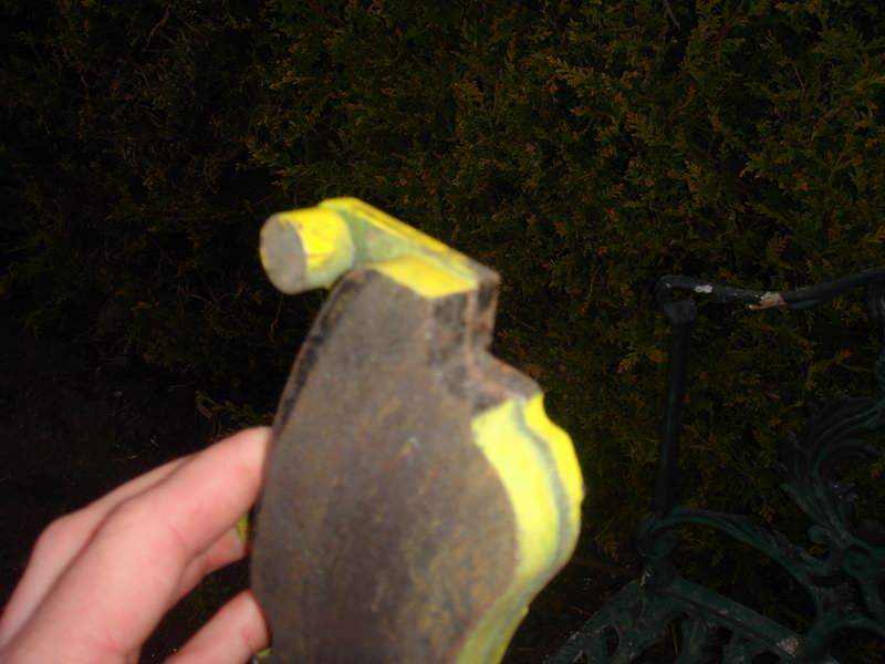

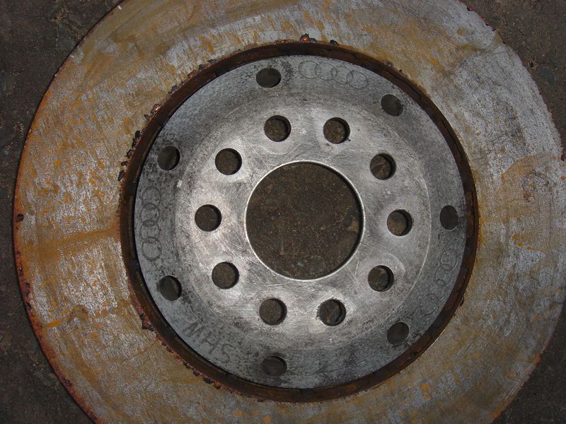

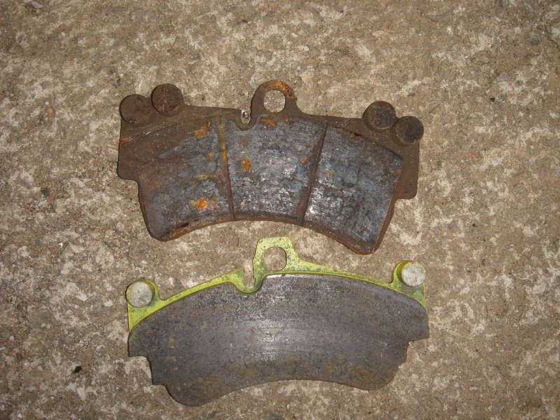

just got back from a few days away to find a big sleel wheelbarrow has fallen onto the front of my already shagged car thus making it more shagged to the tune of a wing bonnet and bumper which will all need a respray , i could have cried. anyway heres a photo of the disc as promised and a couple of the pads both are pagid the knackered being black and the other being a yellow. the yellow one seems to have been modified with a grinder and only has 2 sticky up cylinder type bits whereas the black pads have 4 each. all im after is some decent pads for day to day use giving a good bite from cold but not fading away. oh and just to add to my misery when changing the link pipes round one of the fittings doesnt seal any more so the calipers off to the machine shop tomorrow if i dont chuck it in the bin first, im pretty fecked off tonite, any advice on pads appreciated.

the black pads in the pic are like what i had fitted in my car..i paid £55 for a set IIRC..no squeaking and lasted very well..mite still be in there unless they have been changed by the car's present owner..

Looks to be same as what I have -

Post by bobbler » Fri Apr 04, 2008 11:13 am
Numbers from the rear of that pad -
HB501 HPS
HAWK7266-2-FF
025-1AH01F
Have a look on here too, should be easy enough to find another compatible pad - http://www.livermoreperformance.com/por ... _pads.html
