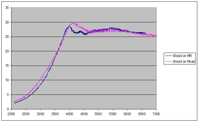

It is better to setup the car on the road as it is more realistic. Only after you have finished that then get the car on the dyno then you can make some fine tuning tweaks just so you get the peak power or torque to what is safe.
THe big problem with the RR is there are very few that are realistic enough. i can show you logs of a 4th gear runs on the road then on the dyno and it shows how unrealistic a dyno can really be.
There is no problem logging mixture on the road - we log at 60 samples/second.

comparison of boost
rr comparison pic.JPG (31.58 KiB) Viewed 875 times

doug ive seen a few dyno's that run from the wheel hub..in other words bolted directly to the hub with the wheels removed..would that suit the
S4/RS4 for gaining the correct figures..i know you cant stop transmission loss but atleast the wheel/tire size would be an issue..

they still have isues with loads over the revs.
(Can you aimagine a shootout day removing wheels on every car!!)
