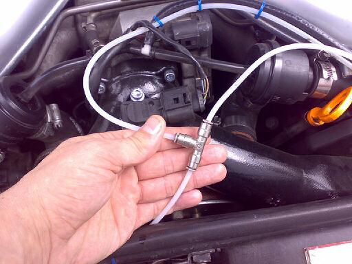

I got a really nice t piece for the 4mm that runs to the injectors. Its push fit and stainless. looks good and ensures a good seal.
http://www.pirtek.co.uk/
S4 Crazy Horse. Ringsticker & MRC black magic.
kies4
Posts: 465
Joined: Fri May 20, 2005 6:06 pm
Location: Ipswich, Suffolk
Post by kies4 » Tue Aug 21, 2007 3:31 pm
better show in pictures

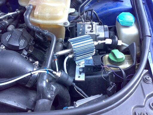

Post by kies4 » Tue Aug 21, 2007 3:33 pm
and the pump and pressure sensor
