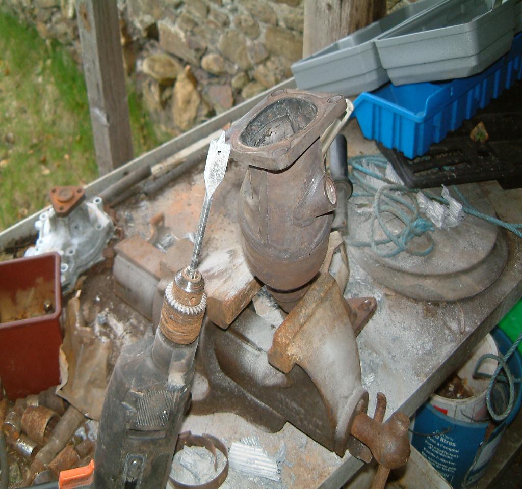

here is my weapon of choice for gutting. My Auger just overheated this flat blade although it kind of destroyed its self it went through the cat easy and fast
pre-cats 003.jpg (145.16 KiB) Viewed 813 times

I tried one of those, 25mm i think, but it was a bit too much for it, my first auger went soft(10mm), also rs4 cats are double the density of standard s4 units, so twice as hard theoretically........ nice effort ... how does it improve in your view mate....

Going by my RS meter I would say 10 -15 bhp easy. I also advanced my timing which makes for a very fast S4. It is much more responsive and the turbos seem to spool up quicker now. It is deffo worth doing.
