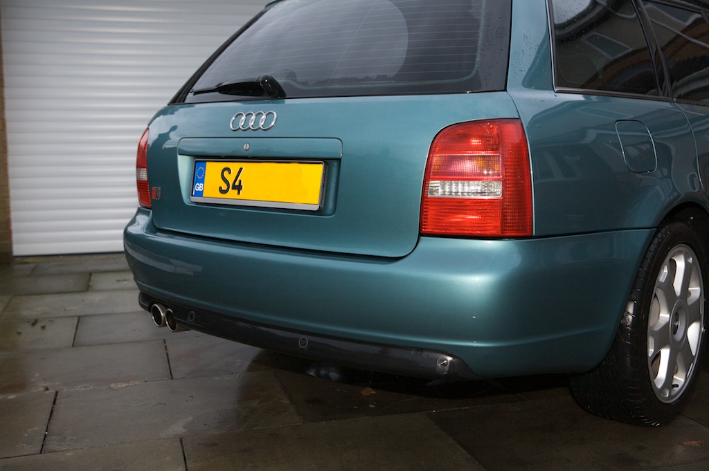

Not a great pic, but here's one of the back of my car.
http://www.dpe.org.uk/cars/images/5-3.jpg
You can see two of the sensors in the black valance.
So I think that the rear APS for the S4 (indeed was not offered to UK customers, but available from other EU dealers including for UK-spec cars) actuallt requires a completely different rear bumper.

I've attached a few pictures of the finished back bumper.
Sorry, but I didn't take any during the installation.
To do the job, remove the rear bumper and you will see the pre-marked sensor holes. I drilled them out using a 25mm drill. Each sensor is held in place by an 'S4 mounting part'. They are handed and there are 2 left ones and 2 right ones. These mounting parts consist of a plastic holder for the sensor and a lighter grey metal cylinder that pushes through the hole that you just drilled. Each sensor is then pushed into the mounting part with a click.
Because I bought both of the required Audi wiring harnesses, installation was fairly straight forward.
The external wiring harness connects the four sensors and is completely waterproof. It passess through a hole in the the body on the right side once a plastic plug is removed. There is a moulded grommit on the external harness that seals the hole.
I had to remove both of the rear boot trim panels, the rear seat bottom and the right hand internal sill trim to do the job.
The buzzer unit fits on a plastic bracket behind the left hand boot trim. The control unit fits in a foam packing under the rear seat on the right side. The internal harness connects the buzzer, the control unit and the external harness.
The internal wiring harness then runs under the right hand sill trim to the multi connector block in the drivers footwell under the fuse box. Here I connected the 'k' line, power, earth, vehicle speed wire and reverse wire.
I still have to connect the 'trailer attached' wire to the control unit as there is a factory tow bar fitted to my car; but as I don't intend towing, I may not bother.
The control unit is programmed by VAGCom and all works well.
This is not cheap compared to after market systems. It cost me about £500 for all the bits (the 2 wiring harnesses were £190, control unit £90 and each sensor was £50.)
There is something about having an OEM retrofit though, and being able to programme it through VAGCom is something of a fetish don't you think?
The system works great and stops me from reverse parking like an idiot (ie leaving a 6 foot gap behind the car because I'm too paranoid about pranging it.)
I must say that without ETKA and ELSAwin, this would have been non starter for me.
Hope this helps.
Mike

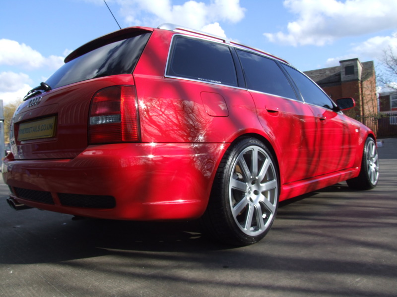

Mike I'm not very DIY-ish with cars! Anyways I think you are right the RS4 does not have that section in its bumper.....It looks much better on the S4 than the RS i think having ti stick it in the bumper. Those other sensors whcih act as the parking aids are also very good!!!!!!
