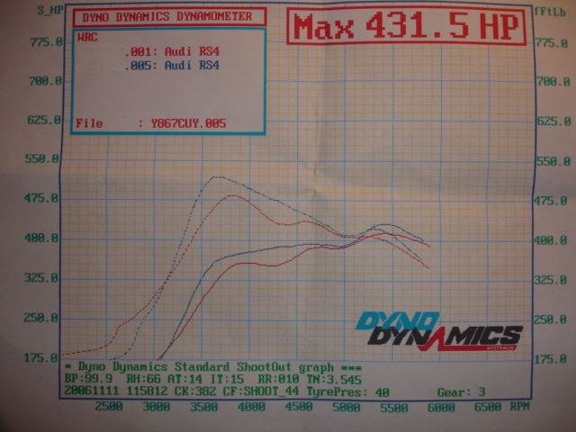

Graph: did expect 440 bhp to be honest but pretty happy with the performance on the road....Plenty of torque as well. More is possible but it is good enough for me :wink:

graph

Red line: with precats, bleu line :without precats.........!! :bigblink:

Did you get the at the wheels figures too? Never had likely flywheel figures on either of the cars I've had on dyno dynamics dynos.
Shows a worthwhile difference in the pre-cats though. The lower plot is boost isn't it?

yeh, the peak boost come much earlier. I really do like the torque curve..... :lol:
Would be curious to compare with another one with remap+milltek sport cats ( around 440/450bhp ) anybody??

have you logged your car with vag-com. I'd like to see your maf values. Mine hit the limit of 364.08 at around 5200-5500 rpms at about 1.6-1.5bar. log block 003 so you get timing as well
could you also do a third gear 3500-7000rpm block 003 WOT run so we can calculate your FATS time too?
That 430 sounds a bit low IMO for 1.4bar high rpms?

430 sound a little bit low, it is true but it is plenty on the road!! Will i notice the difference if i had 10 bhp more.....i don't think so. Would be interested to have some opinions from other RS owners. 8)

The torque is the daddy tho ... thats what gives the kick, and u seem to have a LOT of it!
My old S4 engine with KO4 treatment had 363 hp, but, 414ftlb of torque, which did the job!
Have you done ur FATS yet? That will show how it compairs ...
