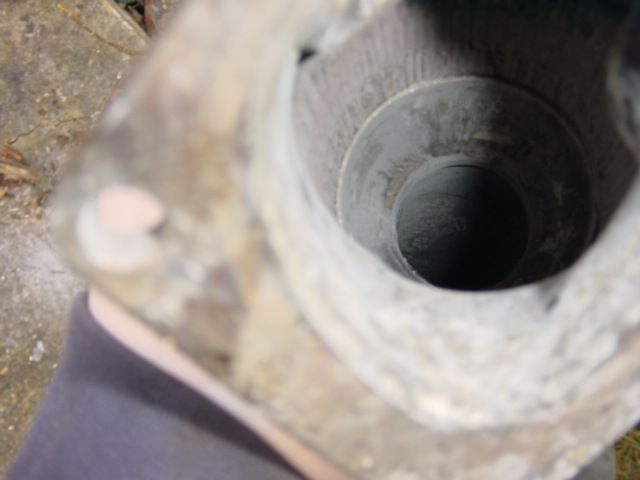

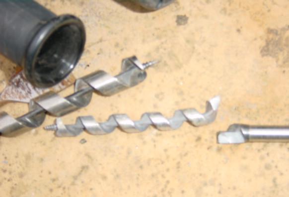

Set about gutting the pre-cats today, found on first few attempts that long drills and sharp chissels etc was quite an effort, after digging around and realising that woodwork wasnt happening, I tried my 10 mm sds auger bit
It made it like ice cream.... first one actually over heated warped itself out and snapped like toffee, used chisels to finish that cat off,
Second cat took about 30 mins to clear out..... :lol:
I used an 18mm auger bits, keeping it cool between blasting through the guts of it.... some piccys attached .. quite pleased with result .... :wink:
10mm got too hot ...
10mm toffee stick & 18mm proper job..JPG (22.02 KiB) Viewed 1781 times
cutting through.JPG (18.5 KiB) Viewed 1781 times
desired rusult - no rewelds needed here ..

why not use hss bits that are use for drilling steel .they wont heat as bad . you can get them with a stepped shank to fit 1/2"chucks

Just to add.... these are rs4 down pipes, which are 400 cell pre-cats, after talking to Minhea, he told me they are a right pig to do, due to it being 400 cell cats, not s4=200 cell cats in downpipes.
I would definately recommend using some auger bits, they just bore into the guts, clearing the destroyed debri as quickly as it can cut.... which wasnt slow .....
keep your auger bit from overheating, you may even get 1x18mm a/bit to do both pipes, but have some long chisels or v.sharp instrument to break down the remanence left between holes, make sure your drill is up to it .. or you may burn the armature/clutch on it.
