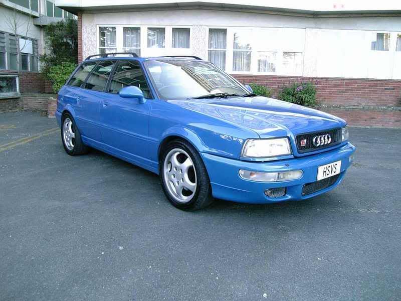

RE: RS2 advice (for a car thats been sitting for a year)
Got it!
Im a happy camper
it looks very nice! im sure you will love it,and some advice,dont be let down from bad engine running or problems that might appear,until you actually give it a good service,you will have those things...
good lluck!
LOOKS great
congrats on your new aquisition, therewasnt many RS2 rhd made anyway so once yours is fettled and back to health (as if it wouldnt be) then ENJOY and welcome to RS ownership
