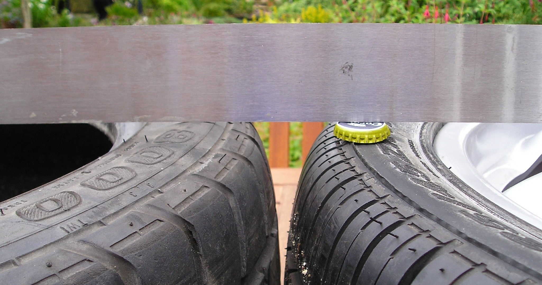

The obsolete Dunlop SP8000 tyres are roughly 8mm wider than the current generation of 225 section tyres. I know this because I laid both side by side on the table on the garden and measured them. (It defies me why the ladies aren't captivated by such behaviour.)
This suggests that current 245 sections, at 20mm wider than the current 225, would be 12mm wider than the original equipment Dunlops which were developed specifically for the car and is why modern 245 section tyres fitted to RS2s rub on the suspension and are to be avoided.

Using the internationally recognised unit of measurement, the current 225 section is one prised off beer bottle top narrower than the original equipment SP8000 245 section.

Depends on the 225. The new Goodyear asymmetrical has a marked outer rim protector. I could not see any difference in overall width. But then I did not go as far as the 'beer bottle top' method!

Good point, Alastair.
The 225 in this exacting comparison is a Pirelli P-Zero Rosso.

Rallyejames has a different make of tyre but 225 and it appears to be a different width (noteably thinner) but at present we haven't done the bottle top test, to be done at the next meet.

Ive just measured the difference between my spare SP8000 (new) and the tyres on the car Dunlop sportmax 245/40. The sportmax is 5mm wider than the original tyres. I have had no problem with tyres rubbing. The tyres were fitted by the previous owner at the Audi main dealers in Paris Levallois.
I also have some spare wheels with Bridgestone Potenzas 245/40 - I shall measure them also when I've a minute. I think it is important to measure with the wheel off the car with the tyre on a rim to get true values.
