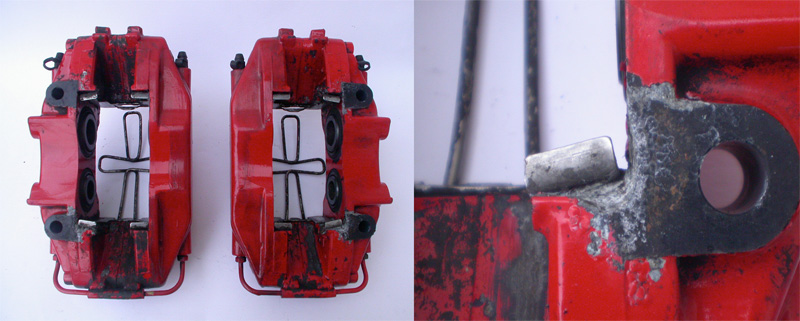

Can you tell where is the sound coming from?
If the sound generally happens when at constant speeds and the noise varies as you turn the steering wheel or temporarily goes when you gently dab the brakes, it may be a wheel bearing on the way out or it may be a bit of plate lift due to corrosion on the calipers (very common), pushing the brake pad onto the disk.
In my case the moaning was a combination of the two. I replaced the front calipers with big reds as well as the rear calipers (although I could have refurbished the old calipers) but the moaning came back a month later at which point I replaced the front wheel bearings which cured the problem.

In that case have a look at the calipers and see if there is any plate lift (see photo). If so this may well be the cause.
Also when I had my wheel bearing replaced the M16 stretch bolts were not tightened to the correct torque (200nm + 90º) and as a result they loosened, which again caused the moan to come back a new set of bolts cured it. NB If your bolts have loosened you can not retighten the old ones and therefore would need new set of bolts. (£3.50 each)
