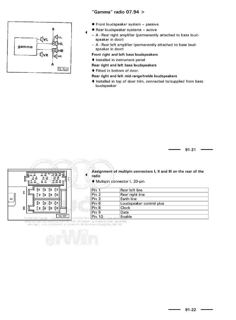

Re: RE: Re: Advice on new speakers and head unit
Beware of just buying the VAG lead- I did that and found my wiring didn't match. Yes it has two ISO plugs but it also has a third red mini ISO plug. I posted a thread here about it but my car must be one of the few with it. I've done some research and while not 100% sure I think my car has active rear speakers and this red plug is part of that setup. Therefore the standard ISO adapter won't work.GlynG60 wrote:Unless someone has butchered your wiring at some point in the past, you should still have the original plugs that will fit straight in. The only thing you might have to change is swap over the ignition switched feed and the permanent live. For some reason VAG always tend to swap these over in their looms for some reason.AAH! wrote:With your feed back the Becker head unit with an ipod dodad seems a sure thing. Did you need a special connector/adaptor to make it fit?
like this: http://www.caraudiodirect.co.uk/index.p ... 92_294_665
RE: Re: RE: Re: Advice on new speakers and head unit
You will only have the third red mini ISO plug if you had an OE Gamma radio, this integrates with this dash computer display etc. Unfortunately/fortunately none of the rhd RS2s in the UK had the factory radio and were dealer fitted with Sony head units. There is an adaptor plug fitted to the rhd RS2s that combines the front and rear speaker plugs to a standard brown 8 pin ISO plug.
With refernce to my previous post the black 8 pin ISO plug is wired as such:
Pin 1, 2 & 3 not used
Pin 4 is the ignition switched positive from terminal 86s on the back of the ignition key switch. (this is not always present unless someone has take a feed)
Pin 5 is a switched positive feed that is used to power the amplifier in the aerial base, this switches on when the head unit is switched on.
Pin 6 is the the illumination feed that becomes positive when the lights are switched on
Pin 7 is the permanent postive from the battery (terminal 30)
Pin 8 is the permanent negative from the battery (terminal 31)
For Becker headunits you need to switch the wiring so the the ignition switched positive from pin 4 to pin 7, and the permanent postive from pin 7 to pin 4.
You will also want to pick up a speed sensitive GALA signal and take this to pin1. This is so that the speed senstive volume control will work (it is also required for Becker SatNav systems, such as the Indianapolis unit). You can pick up a GALA speed signal by splicing into the white and blue wire that arises from the black 10 terminal connector block that can be found at the auxillary relay carrier that is behind the shelf at the base of the steering column. It is the only white & blue wire there.
If you can't find terminal 86s on the back of the ignition key switch you can always pick up an ignition switched feed from the lights on warning buzzer. This is what I did - see here:
http://www.s2forum.com/forum/showthread.php?t=6734
I hope that helps a bit more

Re: RE: Re: RE: Re: Advice on new speakers and head unit
Fortunately being the key point, wish my car didn't have the 3rd plug and therefore I believe amplified rear speakers.GlynG60 wrote:You will only have the third red mini ISO plug if you had an OE Gamma radio, this integrates with this dash computer display etc. Unfortunately/fortunately none of the rhd RS2s in the UK had the factory radio and were dealer fitted with Sony head units. There is an adaptor plug fitted to the rhd RS2s that combines the front and rear speaker plugs to a standard brown 8 pin ISO plug.
Do you have any idea which adapter harness I require or even if I can replace the GAMMA single CD with another unit?

I opened things up today just to see what I was getting myself into and found a lot of wires and it all started to look a bit daunting (see pic).

@ LHD
The assignments on the red plug are like this:
Depending on the head unit you want to fit I think there are adaptors out there, for example the Audi A6 94-02 adaptor (PC9-401) here:
https://www.bluespot.co.uk/install/show_model.asp?id=17
This converts things back to standard ISO plugs by the look of it.
