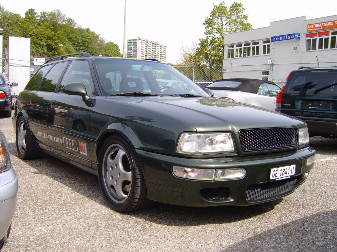

Audi RS2 regusa green
1995 138,000 kms FSH bodywork spotless

The exterior is spotless! It has the audi/porsche RS2 stickers on the side doors stating limited edition anyone seen that before?

Plums wrote: audi/porsche RS2 stickers on the side doors stating limited edition anyone seen that before?
