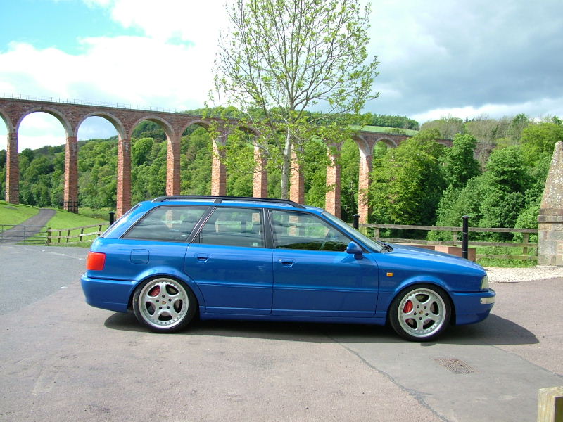

Post by robo » Wed Mar 22, 2006 10:49 pm
It has been done few times

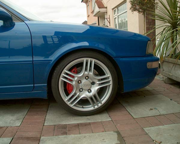

Post by 2-fast-4-u » Wed Mar 29, 2006 6:23 pm
I have 18" Gemballa rims
and my friend Richard used to have Porsche GT something ones

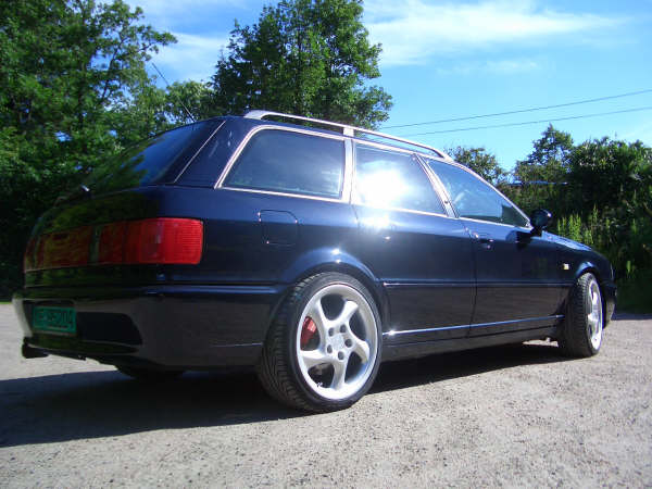

Post by Hansen » Thu Mar 30, 2006 9:54 pm
225/40-18 (8,5)

Post by 2-fast-4-u » Thu Mar 30, 2006 10:18 pm
DamoM wrote:Thanks for those!
What size and offset do you have on your car?
Original Gemballa wheels made to suit the RS2 (no Porsche self re-bored wheels) 8,0J x 18 ET 47 with 245/35 tyres :wink:
