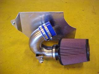

Is anyone aware of a Dahlback style filter to MAF pipe availble in the UK? See pic below.
I know I can do a similar thing with 2 x 90º samco's and some hose clips but it is expensive and unecasarilly over speced and not much more than the Dahlback kit once you bought the filter.
Speaking of filters, my old foam Ramair cone is in need of replacing and is not being made any more. Any suggestions? I've read about the K&N for the cosworth being suitable, but I'm not sure about size. HKS seems good but has reports of poor filtering. ITG and ramair have good reports but size issues again. Apexi expensive. Then there is the question about wet (oiled fabric) or dry (foam). There is just too much to choose from.
And yes I do have a heatshield ; )
All the best...Angus

As far as the Dahlback set-up goes, I have seen this installed and it does look very neat. The heatshield works remarkably well, which is more than a little surprising seeing as it is so close to the turbo & exhaust manifold. There is at least one thread with regard to panel vs. cone filters on www.S2forum.com that is worth reading if you are interested.
Certainly a cone makes things quite a bit louder with induction roar - can be nice if you like that sought of thing, but others (i.e the wife) may find it a little bit tiring on a long drive.
I think with your cat free 3" exhaust system a cone filter will work very well, and it is unlikely that you are worried about the noise issue.

Angus someone on s2forum was seling dahlback filter , I will try to find the link.

Thanks Robo, please let me know if I'm wrong, but I think the site administrator of the S2 forum snapped up the Dahlback filter kit... for testing purposes.

What turbo do you have fitted to your car? At the moment I think paul N is looking at how the Dahlback one has been made up. I got a quote from a local firm to make one up and it worked out alot cheaper than buying one.
