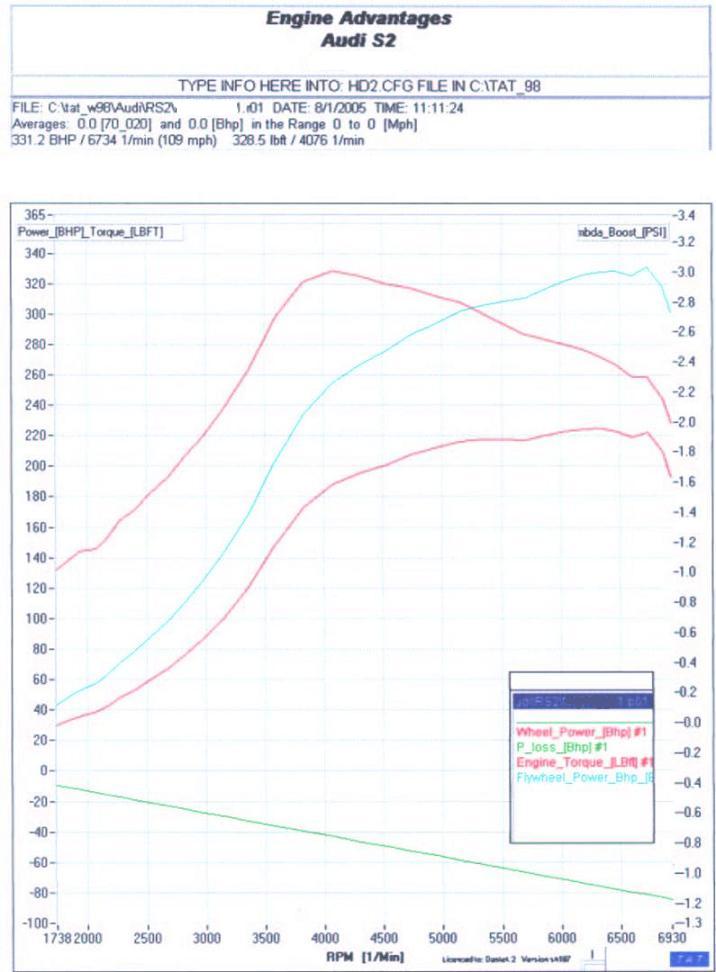

I put my RS2 on the rolling road at the weekend. As far as I know it's stock apart from Jetex Panel filter and S3 DV.

Excellent result. I am sure its standard as the plot curves look very similar to mine ( will scan and post ASAP). Only thought is a stage 1 MTM chip http://www.qstuning.com/list_for_car.asp?car=rs2 .
The RS2 engines were all verified/dyno tested re stated output by porsche so you should expect at least on paper outputs and more with older cared for engines.
Now for a remap eh ?

I'm sure it's standard too. Mihnea has a theory that '95 cars had more power than '94 cars....

Is the torque curve not meant to stay more flat? Has it been samco'ed and tested Pete?

Nice figures there Pete. Excellent. Whats Miks theory behind the '95 cars then?
My Rs had 311bhp prior to mapping when Amd tested it - and came back with 359bhp....Can't remember when mine was registered, pretty sure it was a '94/M.

I think the torque curve looks healthy enough in line with boost peaking at ~4k rpm ? Don't forget boost drops off towards the red line anyway so you wouldn't expect it to be too flat.
I plan to fit the Samco's & leak test at Greg's garage meet next month. :wink: If it had a leak though I doubt the figures would have been so good.

He reckons none of the 94MY cars achieved the claimed figures so Audi changed the ECU for 95MY cars.

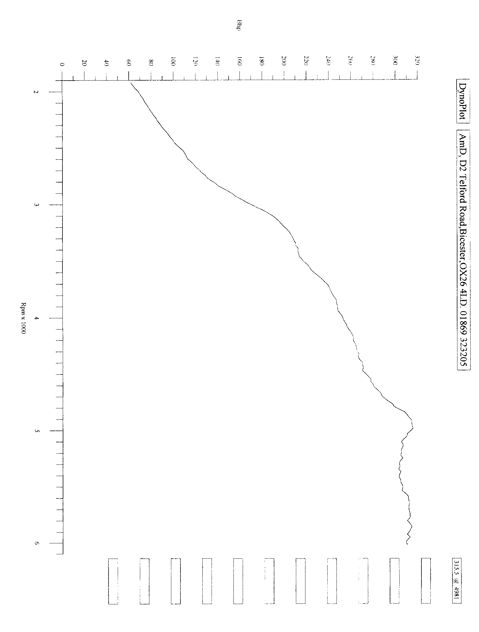

I have to agree with Doug. I have just looked at mine again. Begins plateau @ 3300rpm, flatish from there and tails post 5000rpm. Peak torque 338.6 @ 3726 rpm
Peak power 315.5 @ 4981 rpm and holds past 6000rpm

At last the plots from AMD 030804. Standard car however all following done prior to testing i.e. Air filter Fuel filter DV WGFV/N75 (MAF/sparks within previous 12 months)

Again Managed to get scanner to produce jpg. Quality not great despite max settings

Correction they are huge I am off for a lie down :oops:
