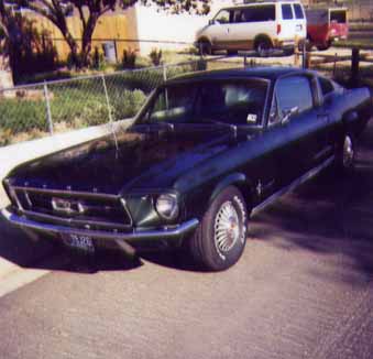

I've always wanted an old mustang - you got any piccies?

I will try post photies, before and after rebuild!
Good to know Richard,
Rob.

Post by Rob20vurq » Wed Oct 27, 2004 11:12 pm
eeeerrrrrr I mean after and before rebuild!!
