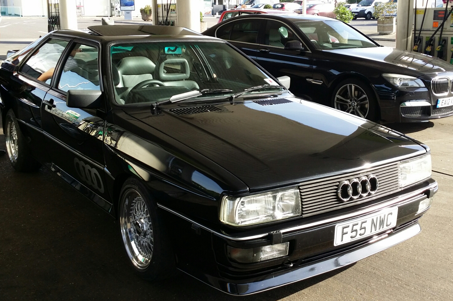

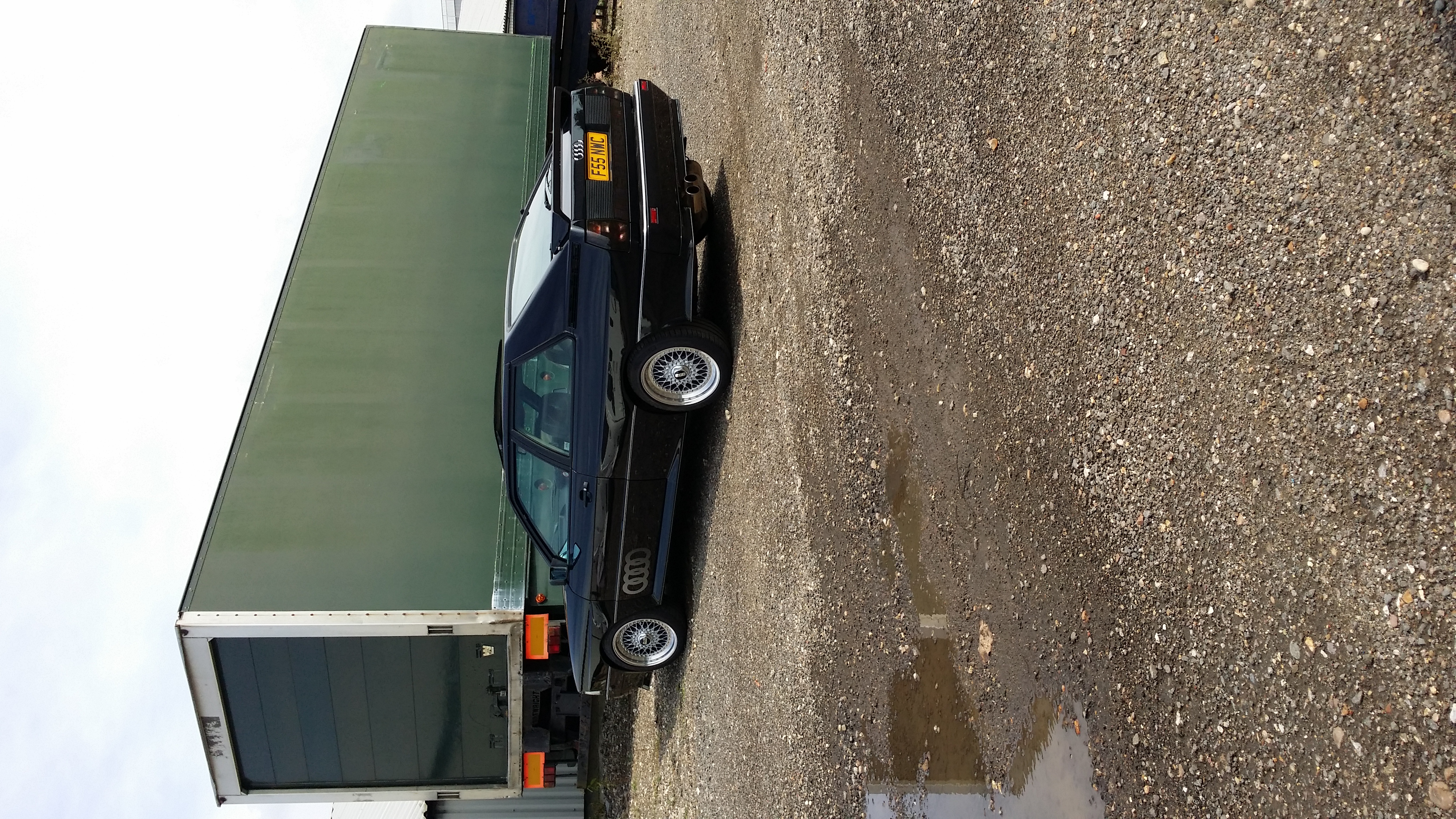

Been a while since ive been on the forums.
Had an rs6 c6 as some may remember but fancied something old skool !
Gotto say the rs2 engine and 6 speed gb are an absolute joy. The one in this has mtm software and has a hybrid turbo, good for 360ps or thereabouts. In a 1300kg car it shifts.
Will be going for an engine build on the adu lump over winter to 500ps and appropriate chassis mods such as coilovers on s2 subframe etc to match. Anyway sharing the love meantime and a big shout out to Ish and the boys at Quattro Coachworks for their expertise and attention to detail.

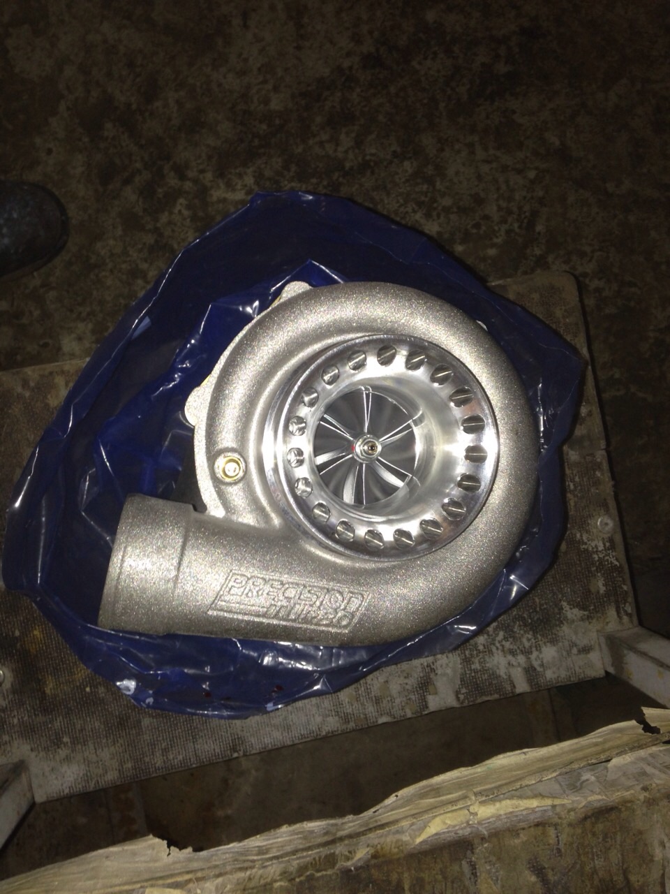

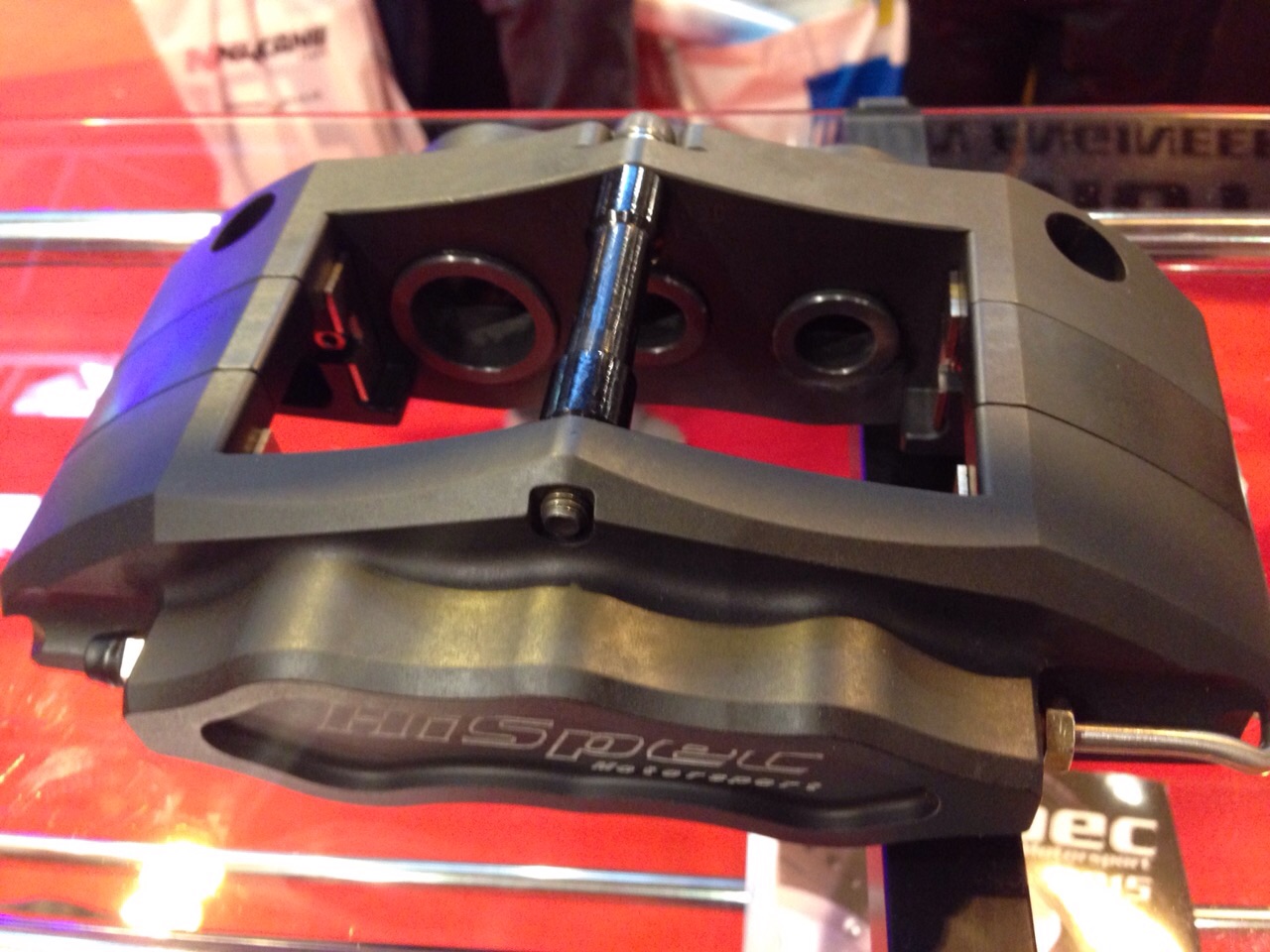

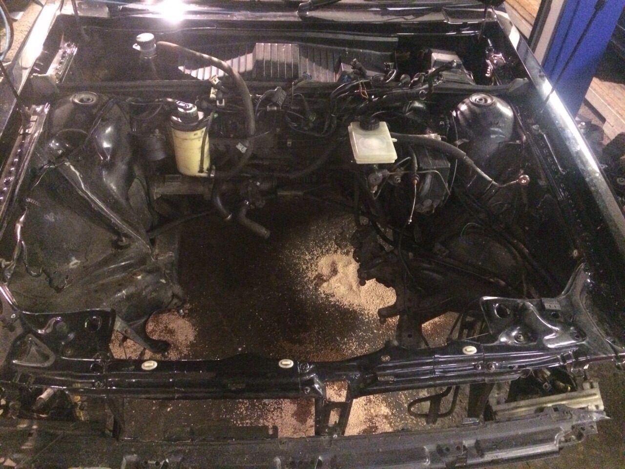

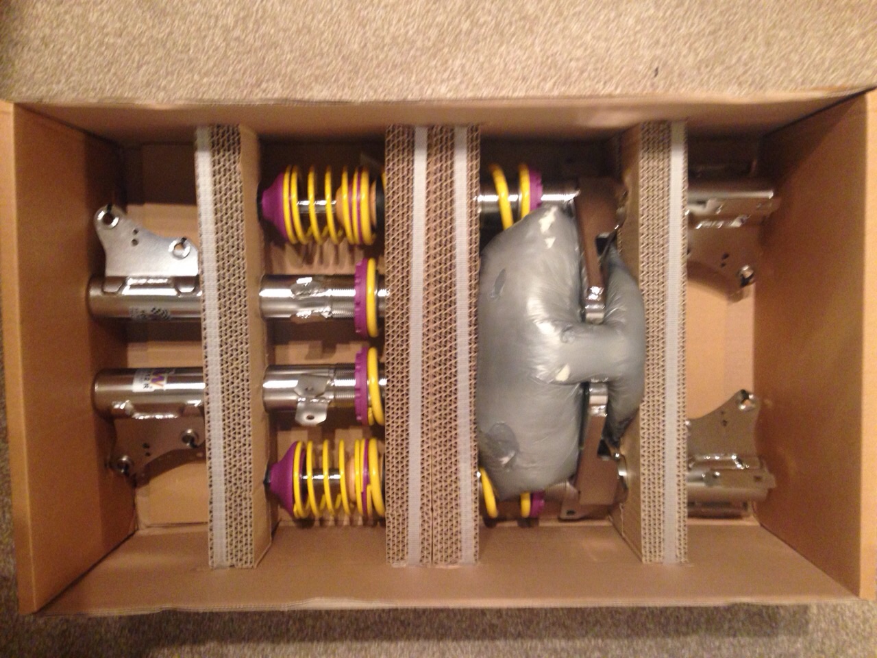

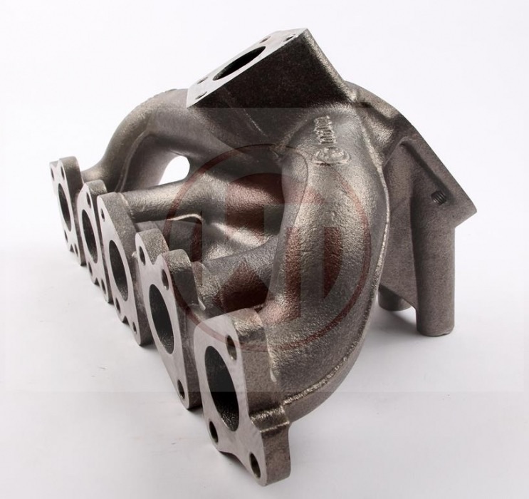

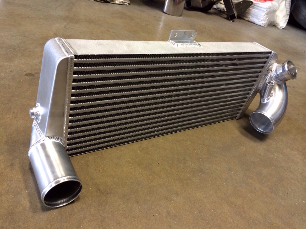

Couple of Ingredients ready for the mixing pot below : Engines out, machine Shop for boring + balancing this week Wossner pistons, etc, the car will have s2 subframes to support the KW v3's, Hi Spec six pot fronts four pot rears, wagner inlet, wagner sport quatty manifold, cutom made gt35 turbo one of only two made by Jonus Racing, and the intercooler is custom made rated to 700+ to give an idea of what this is all about. Too much power maybe but will have to suck it n see

*wibble* love the brakes and turbo. Your house brick is gunna fly... just try to not over rev it...

didnt wanna go chasing numbers but in the end we couldnt resist and wanted to build the baddest car we could within reason so were aiming for over 700ps on e85 or about 670whp now. uprated everything from custom driveshafts to rebuilt strengthend diff, larger rad fan, custom cams and racing lifters, titanium valves, bigger injectors, maxxecu, engine has been bored and crank balanced just finishing off the valve seating now. then the bulky stuff goes back in and then the hard work of plumbing everything in, braided hoses, metal l joints, everything is going to be top notch...then again all very costly too.
