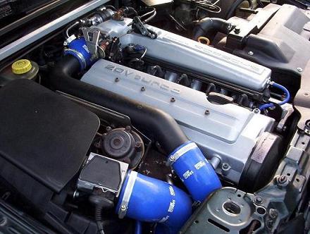

Jubjub/Dean herePete_RS2 wrote:I know Dean (jubjub) & Charlie from S2Forum both fitted the Samcos to their RS2s. I've got the hoses but haven't fitted them yet.
Absolutely no problems at all with the Samco fitment.Well worth the money. When doing this mod i changed all the vacuum hoses as well.Only a couple of extra quid, but, again, more piece of mind......
It also makes under the bonnet look a bit smarter.....
