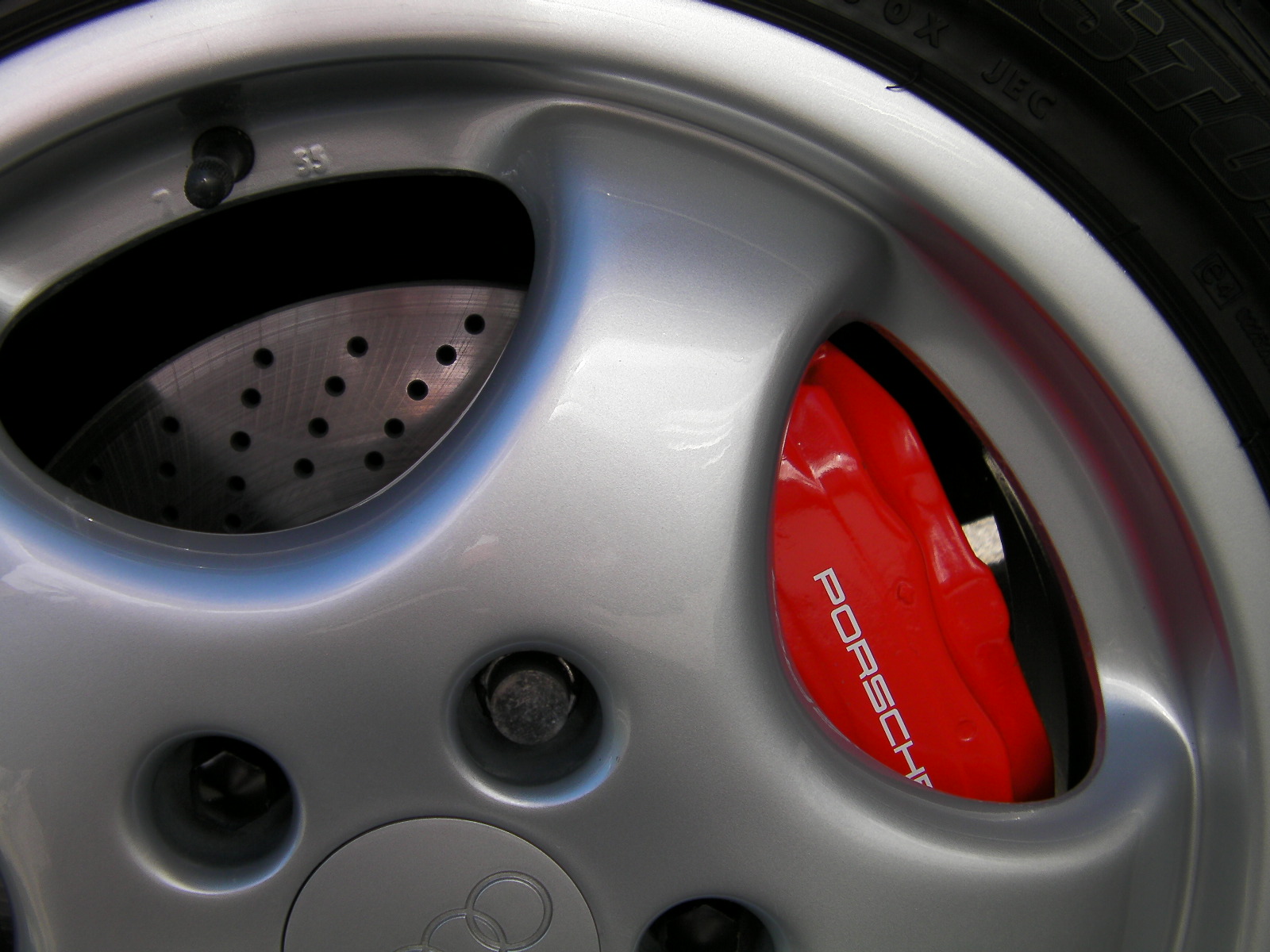

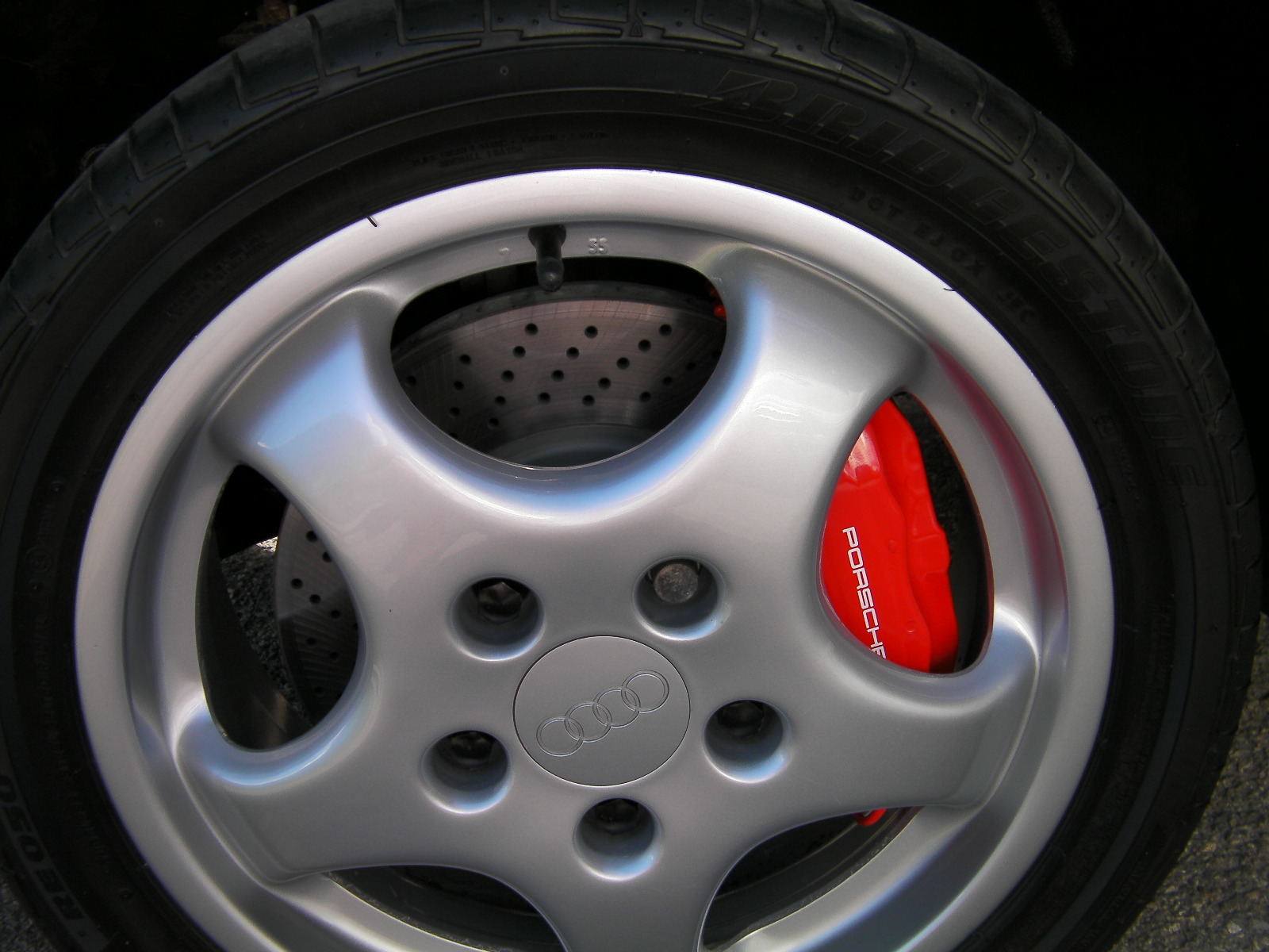

Hope this is of help. I have the big reds on the front and have used the 993 turbo discs until now. The OEM Porsche parts don't fit as the offset at the hub is different to that of the RS2. However I have now tried Porsche 964 turbo discs. They are the same diameter and thickness. AND the offset is the same for Porsche and Audi. This means easier availability (Porsche charges around £190 per disc and there are many aftermarket discs that fit, including Sebring which don't seem to rust as quickly as other aftermarket discs). I enclose a photo, notice the difference from the 993 turbo discs, being that they are not 'two piece' discs like the 993. Part number 965351046 (right disc). The left disc will be nearly the same number (965351045 I think but check),I had already put the wheel back on and couldn't read it!
For info on the rear I use Porsche 944 turbo (928) discs (around 170 euros here in France per disc from Porsche and 130 euros for Sebring cross drilled.)
I have tried EBC red stuff pads but they don't like salt!!, for normal driving Textar are better and half the price.
993 turbo on the front and 968 CS on the back
