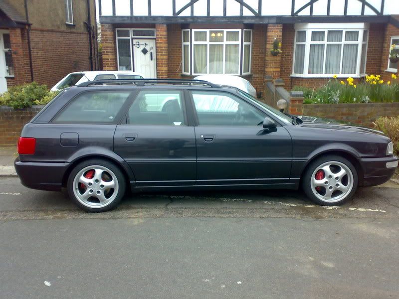

Sweet Clive thanks. Here is the car my mate bought today, does anyone know it ?
John
CliveH
Posts: 4754
Joined: Sat Oct 02, 2004 12:07 pm
Location: Yorkshire, UK
Post by CliveH » Sun Apr 06, 2008 8:17 pm
Looks familiar - was the previous owner on S2forum?
Clive

CliveH wrote:Looks familiar - was the previous owner on S2forum?
Not sure, last 4 stamps in book are from a Clive Sutton Motorsport?
