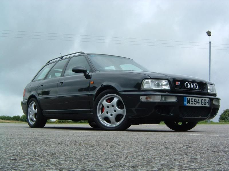

I have finally got round to putting my car on the gallery section. Take a look and let me know what you think.
http://www.rs246.com/modules.php?op=mod ... =414&pos=0
If there is not a difference at least I will know that they have been changed and it knocks something else off my list.

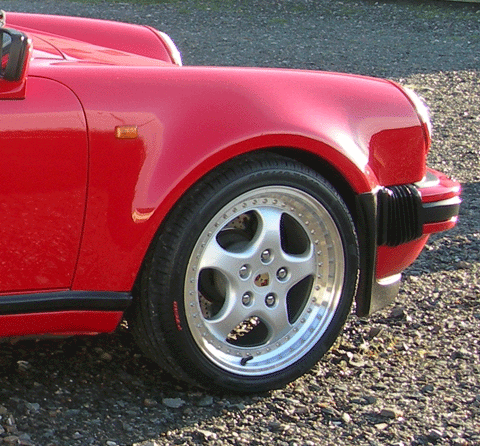

I have a black RHD one the same as you have, but I really like your wheels, what are they, what size of tires do you have, will you sell them (only kidding) I would like to know where I can get a set, very nice car by the wayRS2MAK wrote:Thanks for that. I will get them ordered and see if there is any difference.
Dave S[/quote]
Get your wheels from porsche dealer, you will need four fronts.
http://www.design911.co.uk/
Dave S[/quote]

Get your wheels from porsche dealer, you will need four fronts.robo wrote:I would like to know where I can get a set, very nice car by the way![]()
Dave S
http://www.design911.co.uk/[/quote]
I have std wheels the others look wide compared to mine and not split rim's, I looked in Design911 did'nt see any
http://i123.photobucket.com/albums/o282 ... -10005.jpg
Dave S
Looks good that Mak,
I have the same wheels on mine, the originals need shoving up someones harse! 7" wide on a car like these!!! bobins.
Mine and Maks are 8.5 18 et 52 His looks like its on 225 40 18 tyres as mines on 245 35 18. And they don't make these wheels anymore. Whach the bay,,, they are not cheap!!!!!

Thanks for all the nice comments about the car. I am back up to Fort William in a few weeks so should be able to get some better pictures with nicer scenery.
vasaudigreece - Thanks for the advice on the boost leaks. I have thought about the boost gauge as one of my mates (Jas11n) has one on his S2 and I like the look of it and he says it is pretty useful to have.
dave993cars / robo - As mentioned by rob20vurq the wheels are 8.5 x 18" MTM wheels
rob20vurq - I am running 245 35's and I find no problems with running them. Do you have any pictures of your car as I find that the wheels at the back stick out a bit. Do yours do the same?
