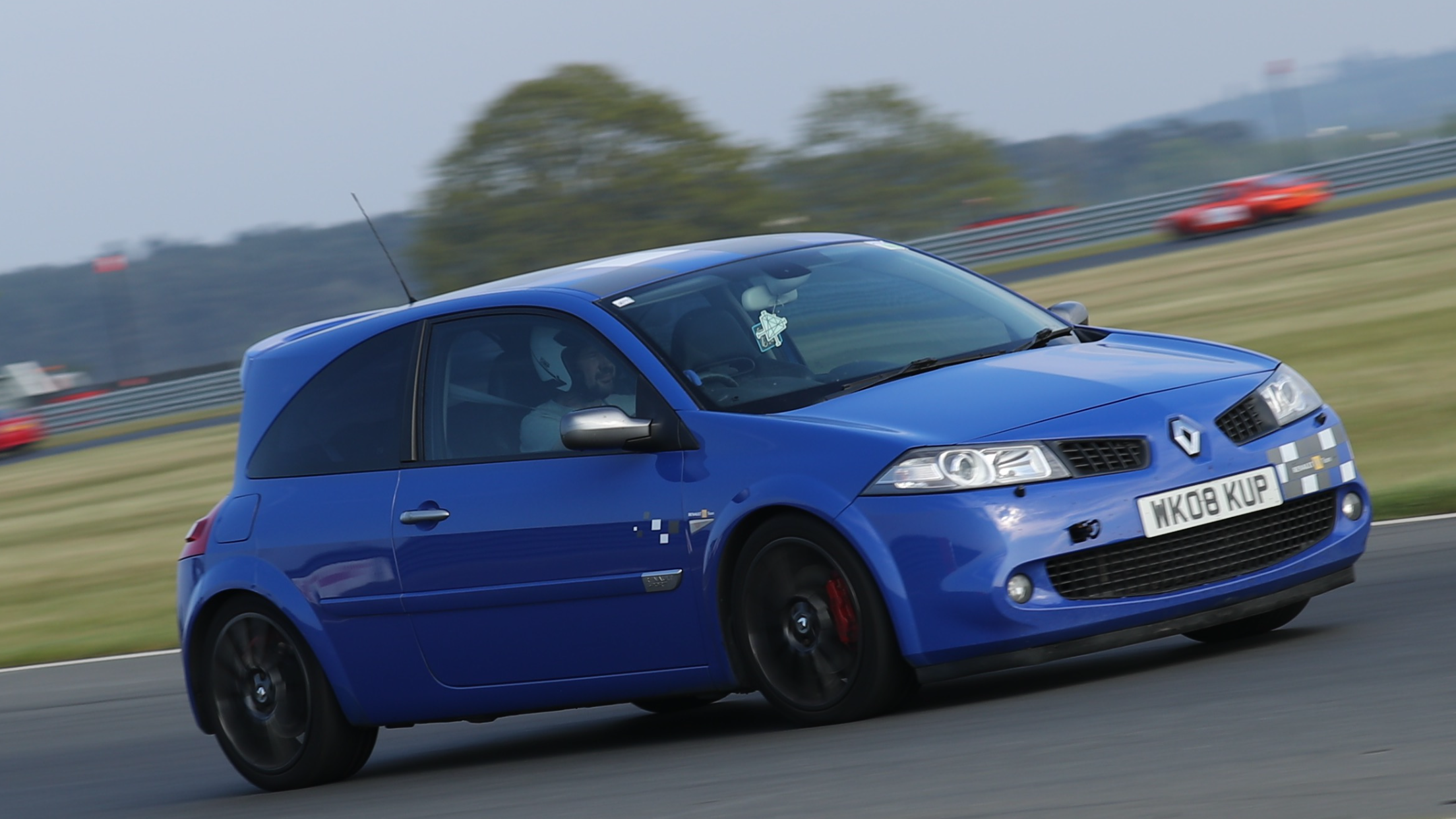

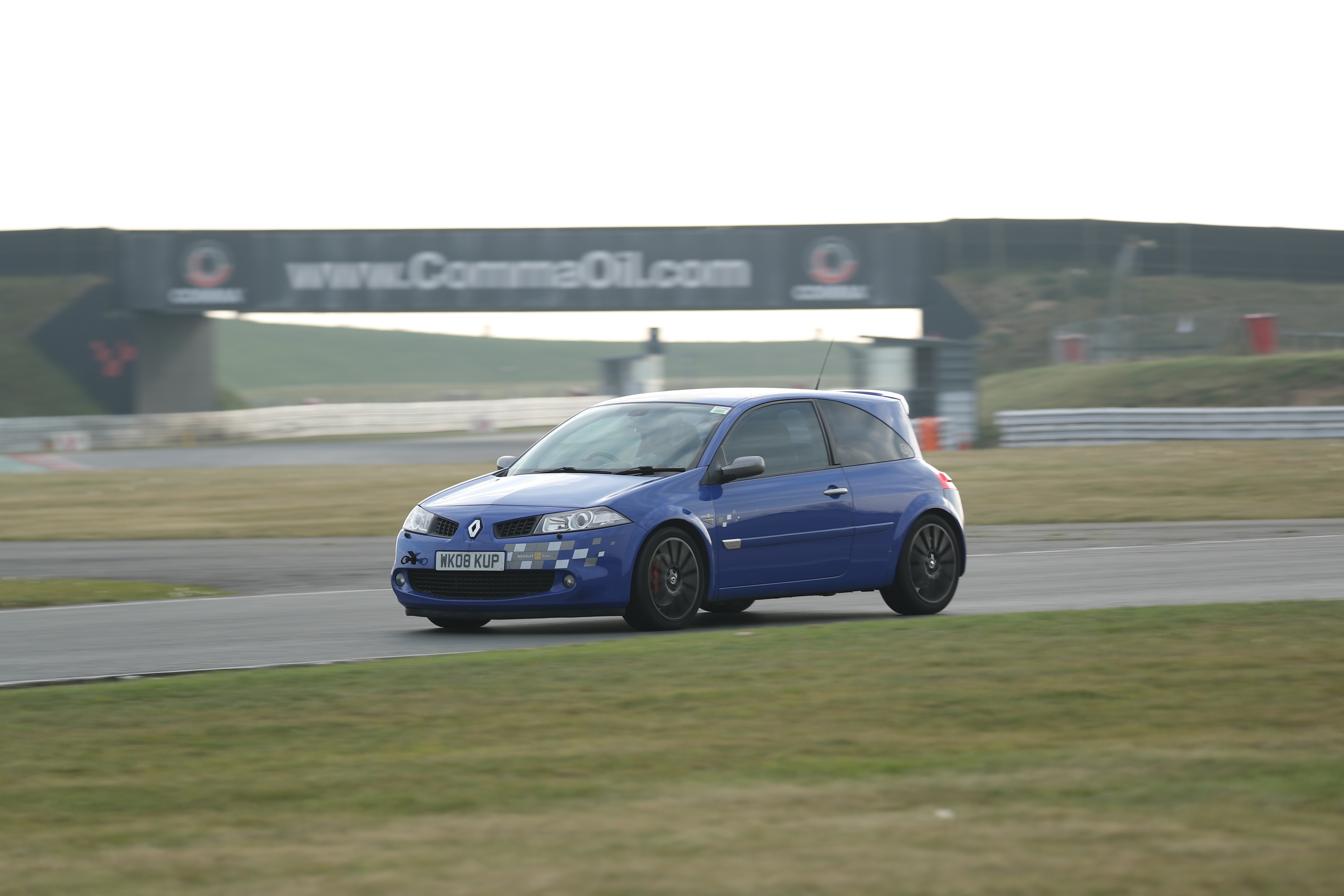

Re: Anyone running a cheap track car?
Post by lynchy » Sun Jul 09, 2017 12:44 pm
Got Cadwell park on the 20thJuly. Done Snetterton 300 back in May ! Car was faultless and a great fun track
Porsche Cayman 718S manual SOLD : :thumbsdown: 2001 black RS4 MRC remap,MRC filter,3" Milltek dp's ,Milltek catback, H&R arbs, Brembo brakes, PSS9`s coilovers, 413 fuel pump, Wagner intercoolers (490bhp. 517 lbs/ft torque )
