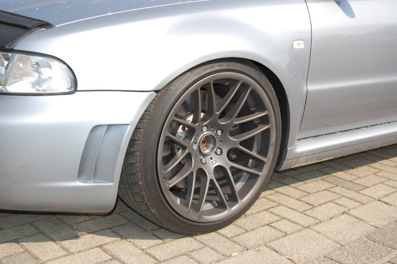

I have seen a wheel that I would like on the car , VMR V710 they come in 18" and 19" but I feel the 18's would better suit the ride and handling, wheel details being :-
18 x 8.5 PCD 5 x 112 or 5 x 120 offsets 35 / 45 or 20 / 35 respectively and finally 57.1 / 66.6 or 72.6
I am no expert on these things , what is the standard wheel ? I had thought about running a wheel spacer even on standard wheels to bring them out to the arch's , think this would be 10MM either side , would the above wheel need a bigger or smaller spacer ?

PCD is 5x112PCD. OEM offset is ET20. Wheel is 18x8.5J.
VMR wheels are lovely, and I was considering them myself but the offsets were not good enough for my car. That said, I came across one in Germany at The Ring recently, which looked ace, but was in a BMW fitment, i.e. 5x120.
I used to run my OEM wheels with a 10mm spacer, but just for looks. You can accommodate a 15mm spacer on the rear, but not on the front.
