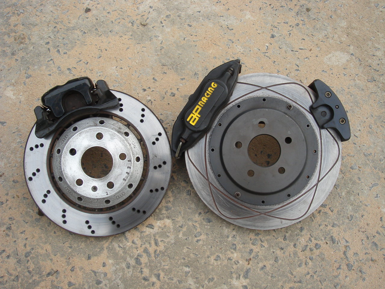

Post by jimbo1234567 » Mon Mar 01, 2010 9:39 pm
the b7 s certainly look better than the b5s, there are different schools of thought as to how much work they do . heres a pic of the b7s when i took them off my car to upgrade to the ap,s

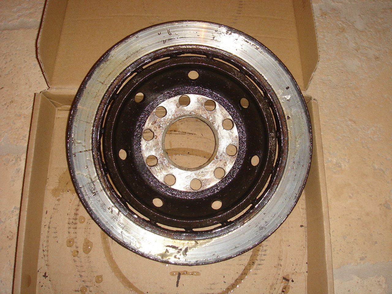

and a b5 disc
