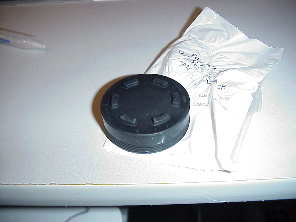

..search audiworld.com and found a pic of said item.
Do I tap it with a hammer and flat blade screwdriver to tighten it up a bit?

RE: Oil leak from rear of head, advice appreciated..
LOL....sorry!
I would have thought you would tap that in with a rubber or plastic hammer.Oil it up slightly if anything
loosen the cam cap off and then tap the blanking plug home,(check that this item has been replaced!!) tighten the cam cap back down,to get a good seal with the cam cover gasket try a small amount (small !!!!) of rtv sealant at the sharp corners of the gasket where it goes over the cam caps.
James,
Thanks for the advice.
Forgive silly question but what/where is the "cam cap" ?
When you say "check this item has been replaced" do you mean the blanking plug in the pic?
I dont think tapping it in will make any difference as i wouldnt imagine its tapered,imolas4uk responce would also be what i would do,be very carefull with rtv if there is an oil feed in the cam cap it will only be small and any excess rtv could block it
Ordered cap, available next day.
Took rocker cover off (getting good at this, 15 mins!)
Loosened the bearing cap and taps the cap out.
Tight fit due to heat shield but came out OK.
So thanks Imolas and Lengster, good advice.
Prizing it out as per Audiworld posts seems a little risky and due to lack of clearance it would be hard to put it back in without cap loose.
Got the part today.
Reassembled as per above using a small amount of sealer where the bearing cap contacts the head as per ELSA.
ELSA says refit the bearing cap then fit the blanking plug using a special lever tool.
Seems like the hard way to do it when its much easier to fit it with bearing cap left slightly loose so that's what I did only torquing it up after the blanking plug had been pushed in firmly.
Interesting the rubber coating of the new plug was much softer than the original which had lost its elasticity.
Didn't oil the plug or put any sealer on it again as per ELSA.
