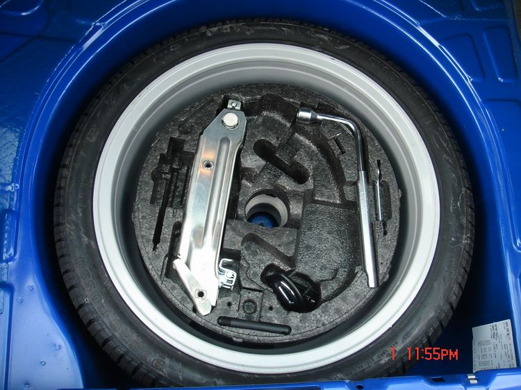

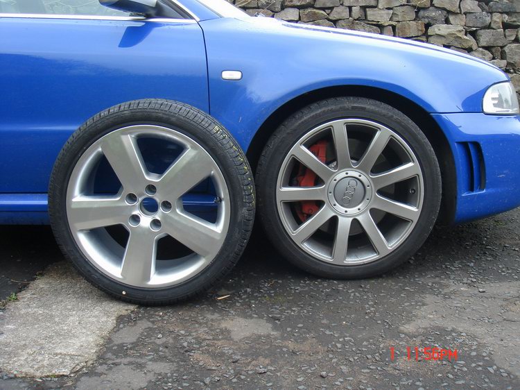

Post by jimbo1234567 » Mon May 04, 2009 10:20 pm
the correct spare for the rs4 is called a winter wheel. its 7.5x18 and wears a 225 tyre. it looks like a rs6 wheel having 5 spokes but has the correct et20 offset. and has a polystryene insert inside it for the jerk etc :nogarors4:

Post by eyeball » Tue May 05, 2009 12:22 am
Thanks for that Jimbo, this has be the best way todo it. It doesnt really matter about being the same style wheel you'll probably never use it. Where would be best for getting this complete set up?

Post by Jarv » Fri May 08, 2009 11:23 pm
Exactly the same as I've got jimbo. Works a treat.
