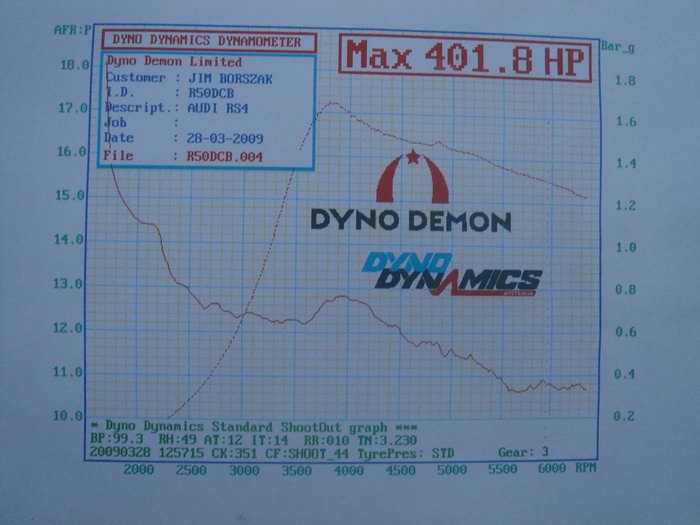

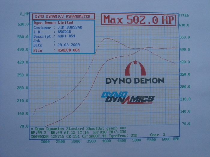

rs6 turbos :D

Post by S2tuner » Tue Apr 07, 2009 12:08 pm
Jimbo, if memory serves, your car was remapped to run 20-22 psi at redline, yet on your graphs I can just see it going under 1.4 bar above 5500 RPM... so that could explain your low power numbers...on the other hand, I have a few dyno sheets of cars that did in the 600s on RS6 turbos, and not just one...
