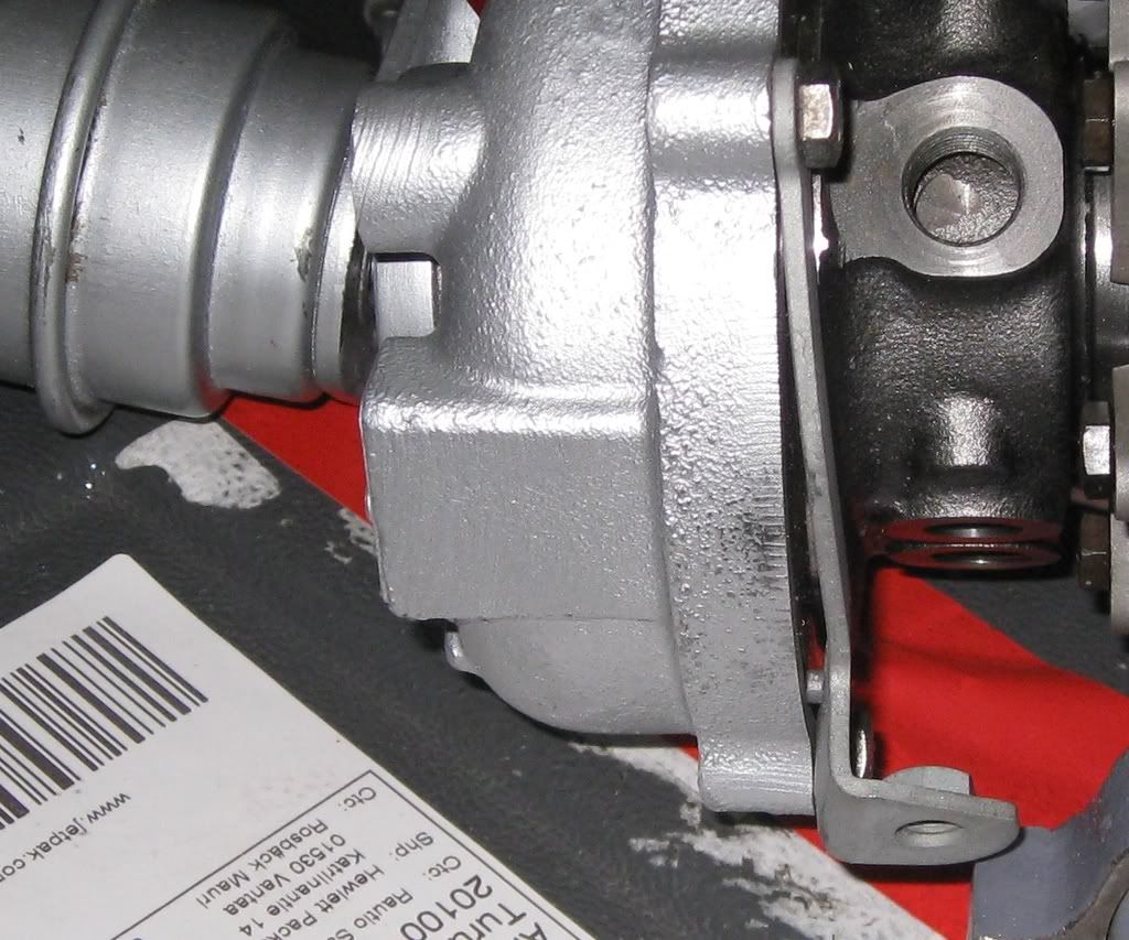

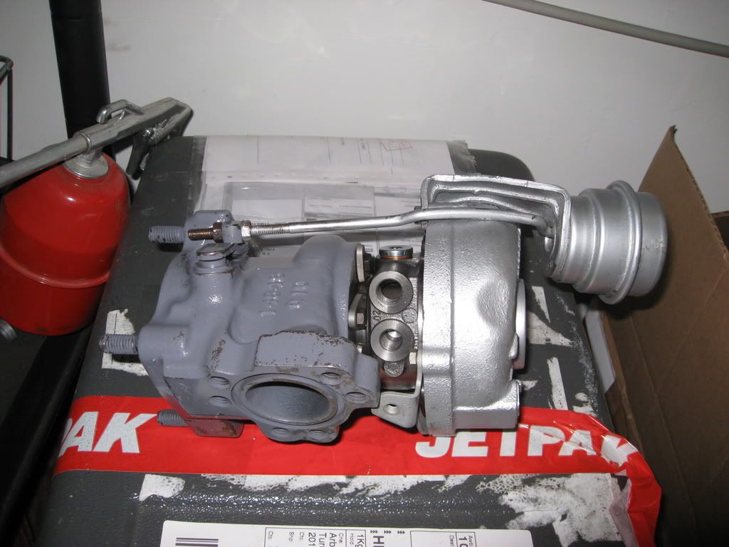

How meny that bars or psi is that 8,5 lbs? I have Hybrid turbos with just center parts from RS6. Rest is regular K04 (26) i think. What should be setup for that and is right moment when it starts to open?
First bit of movement?
My set of new stuff are going in few weeks, depend when i get rest of the parts.
For The moment i can tell you that AVOID company called AUDSPEED becouse they did not send all stuff i ordered and they does not reply any Emails for few weeks. I hope all gonna go well but i fear not.
Work quality is not very "pretty" either.
examples:
http://i239.photobucket.com/albums/ff60 ... tework.jpg
http://i239.photobucket.com/albums/ff60 ... dturbo.jpg
examples:

The finish looks bad on those Audspeed turbos, I hope the internals are ok. In the first pic that wastegate actuator looks bent in a bit, if I were you I would straighten it a little.
You could remove and straighten that c shaped bracket in the second pic, but be careful with the bolts, they are not exactly metric size. You need to make a spanner by grinding out one that is too small to EXACTLY the right size, I found an imperial one that just fitted, then you can remove and replace the 2 bolts.
PSI is the same as lbs , and you can convert to BAR on the internet easily. I would stick with 8 Psi , its up to you.

They seems to be m6 (10mm) bolts. I have k04 turbos in my car now too, so i can use wastegates from there if needed. that locking plate on cold side in my other photo was installed wrong side up, thats why it does not fit. I have allready taken those to parts and checked that all is ok, bild quality is really poor!
How i can know that center section is actual kkk rs6 and not bad copy of that? Is it k28 or something?
They just need loads of work and they are selling those as new. Well, thats what i thougt to get but it was something else
