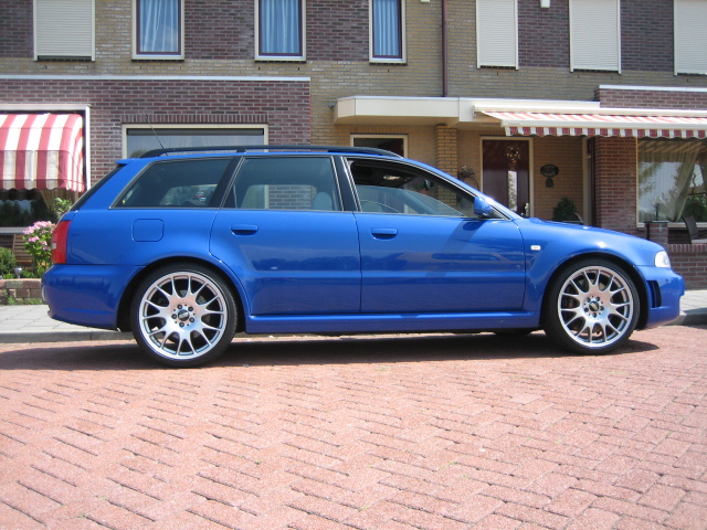

RS4 B5 has ET20....(offset)
01 002.jpg (220.5 KiB) Viewed 1018 times

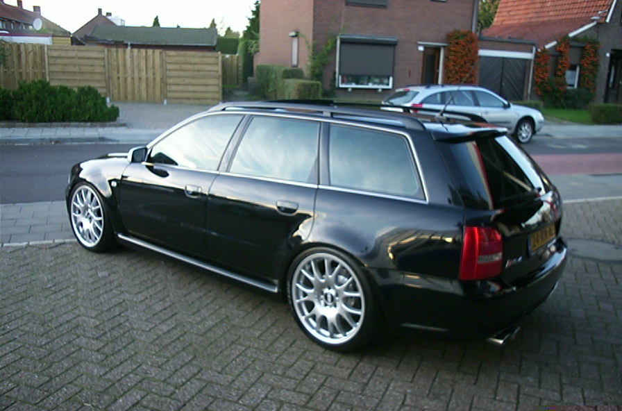

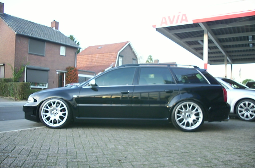

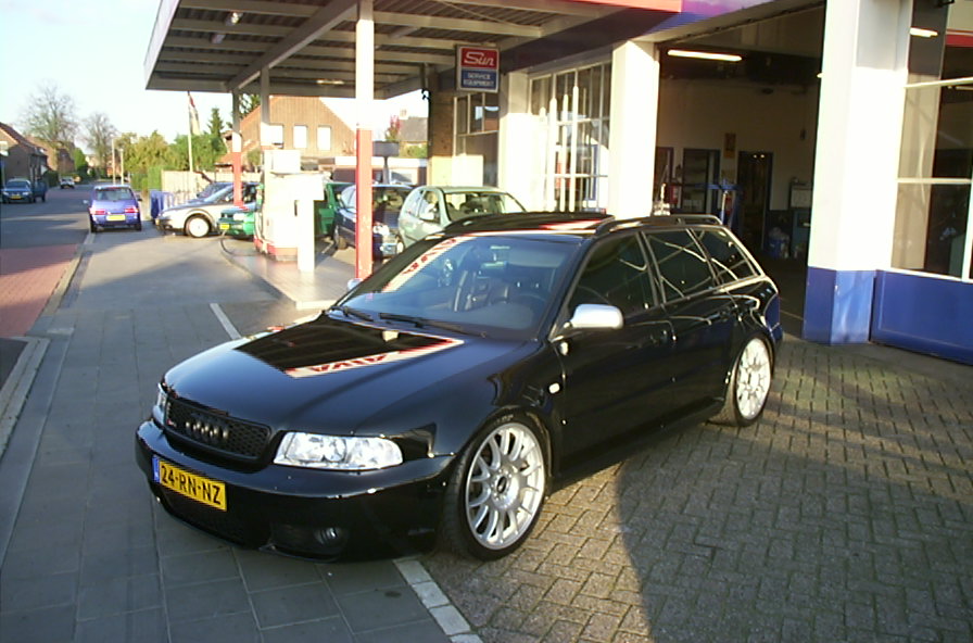

Post by JochieNL » Fri Sep 29, 2006 4:11 pm
19"BBS Challenge ET 35 with 30mm Spacers on front axle and 25mm spacers at the rear.
Works, but it's really the maximum you can get....
